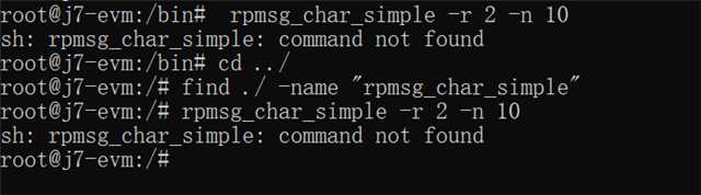

  • hi Tarun
        Does the above information indicate a problem with the original SDK? Can you run ipc test in the original SDK? Thanks a lot.
        (I run the ipc_echo_test failed.
    Usage: rpmsg_char_simple [-r <rproc_id>] [-n <num_msgs>] [-d <rpmsg_dev_name] [-p <remote_endpt]
    Can you try running this way from root ?
    Rproc id will be based on which core from rproc_id.h file from RTOS sdk ?
    Tarun Mukesh
  • hi Tarun
    rpmsg_dev_name & remote_endpt how set ?
  • That's not required if not specific,
    Ex: rpmsg_char_simple -r 2 -n 10
    Tarun Mukesh
  • hi Tarun
        In which path do I run this command?
  • Could you please go through the documentation link i shared with you , it explains whatever you have been asking
                    Defaults: rproc_id: 0 num_msgs: 100 rpmsg_dev_name: NULL remote_endpt: 14
