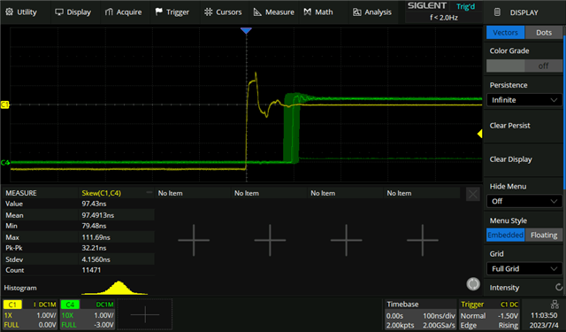

  • Let me try to give a detailed description of the process I have followed to be able to the yet to be validated PPS output on my SK-AM62 E3A EVK.
    First, I have reviewed the (very useful) documentation provided by Nick here: https://e2e.ti.com/support/processors-group/processors/f/processors-forum/1243869/faq-am62-what-is-the-time-sync-router-for-how-do-i-use-it
    It looks like our best bet is to select one of the four SYNCx_OUT signals available on the chip. Like I said in one of my previous posts, I was able to locate those in the AM62X Reference Manual (AM625, AM625-Q1, AM623, AM620-Q1 SPRSP58B – JUNE 2022 – REVISED JUNE 2023). If we go to page 56, 6.3.2.1 MAIN Domain, Table 6-6. CPTS Signal Descriptions, we see:
    SIGNAL NAME DESCRIPTION ALW PIN
    SYNC0_OUT CPTS Time Stamp Generator Bit 0 Output from Time Sync Router B16
    SYNC1_OUT CPTS Time Stamp Generator Bit 1 Output from Time Sync Router A18
    SYNC2_OUT CPTS Time Stamp Generator Bit 2 Output from Time Sync Router C15
    SYNC3_OUT CPTS Time Stamp Generator Bit 3 Output from Time Sync Router E15
    The SK-AM62 rev E3A appears to be using the ALW type AM625. If we cross reference these pins with the board schematics, we get these test points:
    SIGNAL NAME ALW CHIP PIN SK-AM62 E3A BOARD PIN
    SYNC0_OUT B16 J3.28
    SYNC1_OUT A18 J3.7
    SYNC2_OUT C15 J3.10
    SYNC3_OUT E15 J3.8
    On my particular usecase, I'm already using J3.8 and J3.10 for other purposes, so I decided to go for J3.7, SYNC1_OUT, using ball/pin A18.
    Seeing the current k3-am625-sk.dts file, and according to your documentation, it looks like we need to add the following to that device tree file:
                    pinctrl-single,pins = <
                            /* pps [cpsw cpts genf1] in17 -> out12 [cpsw cpts hw3_push] */
                            K3_TS_OFFSET(12, 17)
    +                       /* pps [cpsw cpts genf1] in17 -> out21 [cpsw cpts SYNC1_OUT] */
    +                       K3_TS_OFFSET(21, 17)
    I believe this takes care of the configuration of the TSR, and only that. Exactly like you say in your last post, what happens with chips that are as versatile as this one is that once you get your internals correctly configured you need to find the right pinmux configuration to be able to get your signals to the outside world.
    Now we need to figure out how to configure the pinmux. In order to do that, I have used your online tool SYSCONFIG IDE. Click on LAUNCH, and select the following:
    * SOFTWARE PRODUCT: MCU+ SDK for AM62x (08.06.00)
    * DEVICE: AM62x
    * PART: Default
    * Package ALW
    * Context: m4fss0-0
    Click on Start.
    Once in the SYSCONFIG IDE, Use the diagram on the lower-right part of the screen to locate ball A18:
    There we have almost all we need to complete the pinmux configuration. except for the physicall address of the ball. We can find that in the technical reference manual (SPRUIV7A – MAY 2022 – REVISED NOVEMBER 2022). If we search the ball by its name (EXT_REFCLK1), we will find that Table 6-2046. Pad Configuration Ball Names on page 3648 gives us what we want: F41F0h.
    With this, we can add the following code to the device tree file k3-am625-sk.dts:
    @@ AM62X_IOPAD(0x07c, PIN_OUTPUT, 7) /* (P25) GPMC0_CLK.GPIO0_31 */
    +       pps_pins_default: pps-pins-default {
    +               pinctrl-single,pins = <
    +                       AM62X_IOPAD(0x1F0, PIN_OUTPUT, 1) /* (A18) EXT_REFCLK1.SYNC1_OUT */
            main_gpio1_ioexp_intr_pins_default: main-gpio1-ioexp-intr-pins-default {
    Once these modifications are compiled and built into a bootable image, all you need to do is fire up ptp4l with the desired configuration to get the phcs working, and run this command:
    am62xx-evm:/usr/kernel-selftest/ptp# ./testptp /dev/ptp0 -P 1
    I hope I didn't make any mistakes. I'll try to go over this and will get back to you to confirm, or make corrections.
    Thank you very much for your time and your help.
  • It all appears to be working correctly for now.
    I've had the system running for a litlle bit more than 3 hours at this point, and I have been collecting data from the generated signal. Using linuxptp v4.0 configured with the automotive profile on the SK-AM62 and a PC with an intel i210, this is what the syncrhonization looks like:
