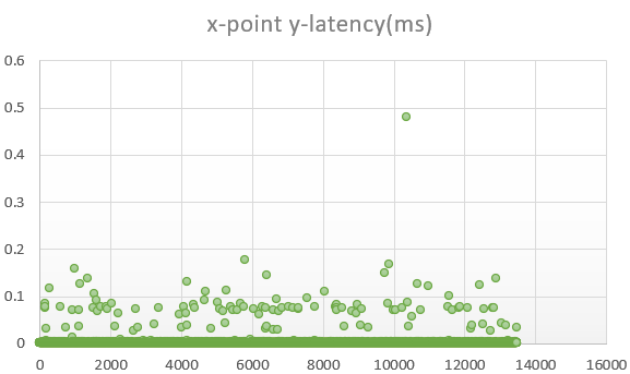

    I have no idea about how to do inline assembly to read CNTPCT_EL0 or CNTVCT_EL0 in AM64x APP level, could you kindly share any example?
    You are right that my outliers could be caused by scheduling / interrupts, because I did not configure the measuring thread to a high RT priority. In my measuring thread, I use ioctl in user space to get the GTC counter values from kernel.
    Kernel:
    gtcCounter = (uint32_t)readl((uint32_t *)(pGtcBase + GTC0_CFG1_CNTCV_LO_OFFSET));
    copy_to_user((void *)arg, &gtcCounter, sizeof(gtcCounter));
    App:
    fd = open(GTC_DEV_NAME, O_RDONLY);
    ioctl(fd, GTC_CMD, &result);
    I tried to read twice of the GTC counter values, and get the value in subtraction between the two counter values to estimate the latency.
    I will try to map the GTC registers via /dev/mem first to see if it was on the order of ~200ns.

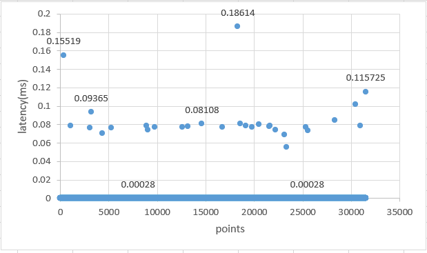

    I was blocked by other tasks for a few weeks. I tried to get GTC through /dev/mem. Most of the time, the latency was around 280ns, but stll somtimes it was almost 0.2ms. And this time I set the test program priority to 79 by cmd 'chrt -pf 79 pid', other tasks' PRI were lower than this one. Did once of the latency test every second. Below is my test results for almost 8h,
    Do you think this is reasonable? And later maybe I will try to read PRU cycle through /dev/mem, and to see if I will get the similar result.
    Best Regards
    xixiguohx
  • Hello xixiguohx,
    I believe the ~200us outliers are most likely due do interrupts/scheduling.
    Are you using a "normal" kernel or an RT-kernel?
    To rule out any effects from accessing the GTC via the SoC bus you could try reading the counter directly, see the function get_cntvct_el0() in that code on GitHub for an example (just a quick google result - I don't know that code otherwise): https://github.com/ARM-software/synchronization-benchmarks/blob/master/benchmarks/lockhammer/include/perf_timer.h
    If you want to reduce scheduling issues you could try core isolation, see this thread for some additional information on realtime performance: https://e2e.ti.com/support/processors-group/processors/f/processors-forum/1172055/faq-am625-how-to-measure-interrupt-latency-on-multicore-sitara-devices-using-cyclictest
    Dominic
