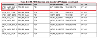

    Adding a more question, in TRM, IPOK_VMON_CAP_VDDS is used for monitoring CAP_VDDS0_MCU that is an internal LDO output, and we don't know the reasonable voltage range. Could you please also help to give a recommended POK threshold for this module? Thanks.
    And we find the CAP_VDDS is not included in the safety manual. Does it mean it is not required for FuSa?

    For the CAP_VDDS, I think you will find that for 1.8V I/O rails, the CAP_VDDS voltage will be 1.8V; for 3.3V I/O rails, the CAP_VDDS voltage will be 3.3V / 2.
    Understood the normal voltage level of CAP_VDDS. Customer wants to confirm that:
    1. Given that this is not included in the safety manual, for functional safety purpose, do they need to use this POK module?
    2. If they need to use that, how to set the POK threshold? Customer don't know the reasonable voltage range of CAP_VDDS?
