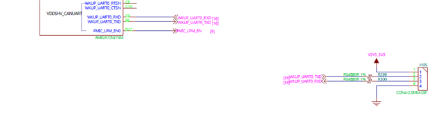

  • My application is that DM-R5 monitor MCU-R5 and A53.And DM-R5 will printf log in wakeup uart.And MCU-UART ,SOC-UART are used for MCU and SOC.Because considerring POWERDomain.

  • I  want to write output to wakeup uart when boot tiboot3.bin and dm_firmware
