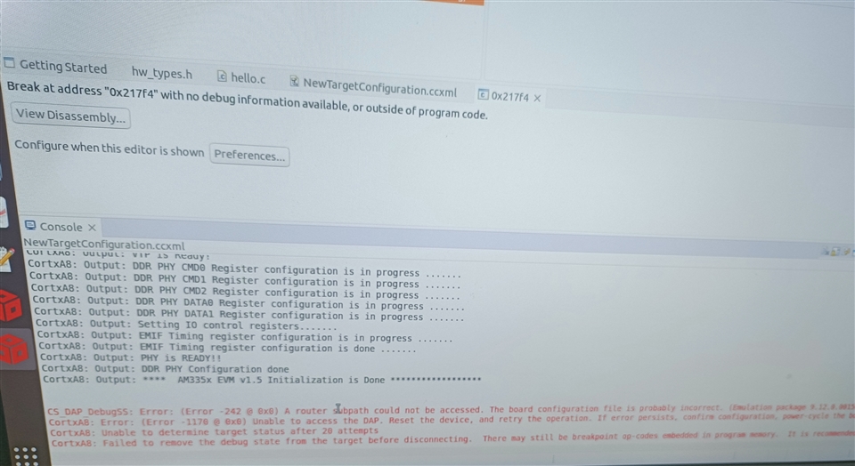

What is gel file to be included in ccs if I am using mt41k512m8rh-125 ddr and I am attaching error when I used am335x-evm.gel file

I am trying to debug hello word program with CCS.
Do i want to change any DDr registers for it?

I am trying to debug the code from ccs and I want to edit the .gel file because my custom board is with 16 bit and 512mib

Yes it is think so.in gel file it runs fine till am335x evm v1.5 initialisation is done .
After that it is showing above error.i am using am335x_15x15_EVM.gel file.
I have changed the DDR3_REF_CTRL to 0x0000C30 is it correct for mt41k512m8rh-125.

After running the ddr initializaition gel (before you try to load the hello world code), try opening a memory window at 0x80000000 to see if you can read write individual addresses. It looks like the DDR init is running fine, but there is some other CCS error you are hitting
James
It appears the JTAG pod is losing connection with the processor. Can you send the JTAG portion of your schematic? What did you do to create your target configuration? Can you disable the GEL function which initializes the DDR and see if you can connect thru CCS successfully?

i added new target configuration file into basic hello world program , added name and click on finish .
in Basic i used am3351 as my board and connection as XDS110 USB Debug Probe
Advanced :
I am using gel file in the location :ccs1240ccs/ccs_base/emulation/boards/evmam3358/gel/am335x_15x15_EVM_v1_3.gel
