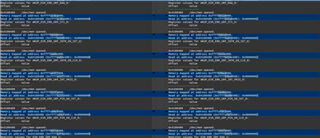

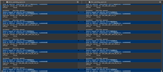

    RTI_WDT and ESM on AM64x SoC for your reference:
    - Kernel WDT needs ESM support to make it work
    - ESM support was added in AM64x SDK 8.2 SPL
    - Basic flow for WDT/ESM SoC RESET: WDT timeout event => Main ESM_ERRORz => MCU ESM_ERRORz => SoC RESET
    - WDT/ESM test cmd in kernel “./runltp -P am64xx-evm -f ddt/wdt_test -s WDT_S_FUNC_GETSTATUS”
    - I'm attaching the log I captured with Linux SDK 8.2 on AM64x GP EVM
    "am64_8.2_gp_wdt_esm_1.txt", where CTRLMMR registers readings on RST_CTRL/RST_STAT/RST_SRC for Main and MCU domains are captured in the attached log file for the following two cases for comparison:
    - POR
    - SoC reset triggered from WDT timeout => ESM SoC RESET
    - AM64x ESM in SPL
    git.ti.com/.../am642_init.c
    -Hong

    => md.l 0x43018170 3
    43018170: 000200ff 00000000 c0000000             ............
    => md.l 0x04518170 3
    04518170: 00000fff 00000001 c0000000             ............

    Thanks for the support with reference to your AM64X WDT test application we tried to do the same for AM62AX Custom board ,PFA of  the logs ,but i am not able to timeout the WDT ,can you please help me on this
    NOTICE:  BL31: v2.6(release):08.03.00.003-dirty
    NOTICE:  BL31: Built : 16:58:45, Aug 25 2022
    U-Boot SPL 2021.01-00523-gbd8cf11a40-dirty (Jan 17 2023 - 16:50:55 -0800)
    SYSFW ABI: 3.1 (firmware rev 0x0009 '9.0.0--v09.00.00 (Kool Koala)')
    am62a_init: board_init_f done
    am62a_init: spl_boot_device: devstat = 0x3 bootmedia = 0xff bootindex = 0
    Trying to boot from RAM
    U-Boot 2021.01-00001-g01ec1fd168-dirty (Jun 21 2023 - 17:08:27 -0400), Build: jenkins-D2H5370_DMSCORE_Int-develop-6
    SoC:   AM62AX SR1.0 GP
    Model: Texas Instruments AM62A7 SK
    DRAM:  4 GiB
    MMC:   mmc@fa10000: 0, mmc@fa00000: 1
    Loading Environment from MMC... *** Warning - No block device, using default environment
    In:    serial@2800000
    Out:   serial@2800000
    Err:   serial@2800000
    Failed to probe am65_cpsw_nuss driver
    Net:   No ethernet found.
    Hit any key to stop autoboot:  0
    => setenv boot mmc
    => setenv bootpart 1:2
    => boot
    i2c_write: error waiting for data ACK (status=0x116)
    pca953x gpio@22: Error reading output register
    switch to partitions #0, OK
    mmc1 is current device
    SD/MMC found on device 1
    Failed to load 'boot.scr'
    Failed to load 'uEnv.txt'
    19079680 bytes read in 793 ms (22.9 MiB/s)
    42663 bytes read in 9 ms (4.5 MiB/s)
    ## Flattened Device Tree blob at 8ff00000
       Booting using the fdt blob at 0x8ff00000
       Loading Device Tree to 000000008fef2000, end 000000008fffffff ... OK
    Starting kernel ...
    [    0.000000] Booting Linux on physical CPU 0x0000000000 [0x410fd034]
    [    0.000000] Linux version 5.10.168-g2c23e6c538 (anil@PPL-565U) (aarch64-none-linux-gnu-gcc (GNU Toolchain for the A-profile Architecture 9.2-2019.12 (arm-9.10)) 9.2.1 20191025, GNU ld (GNU Toolchain f
    or the A-profile Architecture 9.2-2019.12 (arm-9.10)) 2.33.1.20191209) #1 SMP PREEMPT Thu Aug 3 15:13:38 IST 2023
    [    0.000000] Machine model: Texas Instruments AM62A7 SK
    [    0.000000] earlycon: ns16550a0 at MMIO32 0x0000000002800000 (options '')

  • Hi Hong Guan ,
    we ported the required changes to service the watchdog from  samples/watchdog/watchdog-simple.c to our application ,and driver was inserted with below argument
    insmod /lib/modules/5.10.168-g2c23e6c538/kernel/drivers/watchdog/rti_wdt.ko heartbeat=10
    now once the application is stopped ,we observed the register
    RTI4_WDSTATUS Register
    RTI0 0E00 0098h
    While application servicing the watchdog the register value is  0x0E000098 : 0x00000028
    once i stop the watchdog servicing application after 8~10 seconds value is 0x0E000098 : 0x0000003A
    So as BIT(1) is set we assume that watchdog timer is expired and the status is updated accordingly in the registers
    Here the question is
    1)we see the default driver for watchdog triggers NMI "writel_relaxed (RTIWWDRX_NMI, wdt->base + RTIWWDRXCTRL); "
    so how is the error reported to MCUR5 ESM ,is it from A53 ESM to MCUR5 ESM  ?
    2)if its A53 ESM how to redirect the Error interrupt output route to MCU ESM  ?

    After Porting the ESM glue Logic i read before and after ESM related registers and we see there is no change WKUP_ESM0 related register PFA of the files with all the register read values before and after the watchdog
    Before watchdog expire
    WDT_STATUS
    /dev/mem opened.
    Memory mapped at address 0xffff8cd81000.
    Read at address 0x0E000098 (0xffff8cd81098): 0x00000000
    after watchdog expired
    WDT_STATUS
    /dev/mem opened.
    Memory mapped at address 0xffffb398b000.
    Read at address 0x0E000098 (0xffffb398b098): 0x00000032
     we observed only  main ESM related registers changing here j =6
    ESM_ERR_GRP_RAW_6
    ESM_ERR_GRP_STS_6
    ESM_ERR_GRP_INTR_EN_SET_6
    ESM_ERR_GRP_INTR_EN_CLR_6
    ESM_ERR_GRP_INT_PRIO_6
    ESM_ERR_GRP_PIN_EN_SET_6
    ESM_ERR_GRP_PIN_EN_CLR_6
    only BIT(0) of all register of ESM0 main and no WKUP_ESM0 related registers are getting updated i have attached the devmem read of all the register related to same

    the below are the output of base address after watchdog timer expired
    WDT_STATUS
    /dev/mem opened.
    Register values for ESM0:
    Offset       Value
    0x0x4    0x/dev/mem opened.
    Memory mapped at address 0xffffb00ff000.
    Read at address  0x00420004 (0xffffb00ff004): 0x00000107
    0x0x8    0x/dev/mem opened.
    Memory mapped at address 0xffffb44b8000.
    Read at address  0x00420008 (0xffffb44b8008): 0x00000000
    0x0xC    0x/dev/mem opened.
    Memory mapped at address 0xffff88f19000.
    Read at address  0x0042000C (0xffff88f1900c): 0x00000000
    0x0x10    0x/dev/mem opened.
    Memory mapped at address 0xffffb864c000.
    Read at address  0x00420010 (0xffffb864c010): 0x00000000
    0x0x14    0x/dev/mem opened.
    Memory mapped at address 0xffff9bba1000.
    Read at address  0x00420014 (0xffff9bba1014): 0x00000000
    0x0x18    0x/dev/mem opened.
    Memory mapped at address 0xffff8c009000.
    Read at address  0x00420018 (0xffff8c009018): 0x00000000
    0x0x1C    0x/dev/mem opened.
    Memory mapped at address 0xffffb958f000.
    Read at address  0x0042001C (0xffffb958f01c): 0x00000000
    0x0x20    0x/dev/mem opened.
    Memory mapped at address 0xffff876b2000.
    Read at address  0x00420020 (0xffff876b2020): 0xFFFFFFFF
    0x0x24    0x/dev/mem opened.
    Memory mapped at address 0xffff82921000.
    Read at address  0x00420024 (0xffff82921024): 0xFFFFFFFF
    0x0x28    0x/dev/mem opened.
    Memory mapped at address 0xffffa2aa2000.
    Read at address  0x00420028 (0xffffa2aa2028): 0x00000000
    0x0x2C    0x/dev/mem opened.
    Memory mapped at address 0xffff9d6b8000.
    Read at address  0x0042002C (0xffff9d6b802c): 0x00000000
    0x0x30    0x/dev/mem opened.
    Memory mapped at address 0xffff9267d000.
    Read at address  0x00420030 (0xffff9267d030): 0x00000000
    0x0x40    0x/dev/mem opened.
    Memory mapped at address 0xffffa3e57000.
    Read at address  0x00420040 (0xffffa3e57040): 0x00000000
    0x0x44    0x/dev/mem opened.
    Memory mapped at address 0xffffa5f97000.
    Read at address  0x00420044 (0xffffa5f97044): 0x00000001
    0x0x48    0x/dev/mem opened.
    Memory mapped at address 0xffffb299f000.
    Read at address  0x00420048 (0xffffb299f048): 0x00030D40
    0x0x4C    0x/dev/mem opened.
    Memory mapped at address 0xffffa778e000.
    Read at address  0x0042004C (0xffffa778e04c): 0x00030D40
    0x0x50    0x/dev/mem opened.
    Memory mapped at address 0xffffa3e79000.
    Read at address  0x00420050 (0xffffa3e79050): 0x000186A0
    0x0x54    0x/dev/mem opened.
    Memory mapped at address 0xffffb9d7c000.
    Read at address  0x00420054 (0xffffb9d7c054): 0x000186A0
    0x0x58    0x/dev/mem opened.
    Memory mapped at address 0xffff88054000.
    Read at address  0x00420058 (0xffff88054058): 0x000186A0
    0x0x5C    0x/dev/mem opened.
    Memory mapped at address 0xffff8f91a000.
    Read at address  0x0042005C (0xffff8f91a05c): 0x000186A0
    0x0x400    0x/dev/mem opened.
    Memory mapped at address 0xffff8a5f5000.
    Read at address  0x00420400 (0xffff8a5f5400): 0x00060080
    0x0x404    0x/dev/mem opened.
    Memory mapped at address 0xffff99990000.
    Read at address  0x00420404 (0xffff99990404): 0x00000000
    0x0x408    0x/dev/mem opened.
    Memory mapped at address 0xffff95b5a000.
    Read at address  0x00420408 (0xffff95b5a408): 0x00000000
    0x0x40C    0x/dev/mem opened.
    Memory mapped at address 0xffffbf667000.
    Read at address  0x0042040C (0xffffbf66740c): 0x00000000
    0x0x410    0x/dev/mem opened.
    Memory mapped at address 0xffffb938c000.
    Read at address  0x00420410 (0xffffb938c410): 0x00000000
    0x0x414    0x/dev/mem opened.
    Memory mapped at address 0xffff964f0000.
    Read at address  0x00420414 (0xffff964f0414): 0x00000000
    0x0x418    0x/dev/mem opened.
    Memory mapped at address 0xffff8e092000.
    Read at address  0x00420418 (0xffff8e092418): 0x00000000
    Register values for WKUP_ESM0:
    Offset       Value
    Memory mapped at address 0xffffa2cca000.
    Read at address  0x04100004 (0xffffa2cca004): 0x00000103
    Memory mapped at address 0xffffa1ea1000.
    Read at address  0x04100008 (0xffffa1ea1008): 0x00000000
    Memory mapped at address 0xffffb8aae000.
    Read at address  0x0410000C (0xffffb8aae00c): 0x00000000
    Memory mapped at address 0xffffbadd8000.
    Read at address  0x04100010 (0xffffbadd8010): 0x00000000
    Memory mapped at address 0xffff8cf9e000.
    Read at address  0x04100014 (0xffff8cf9e014): 0x00000000
    Memory mapped at address 0xffffb2b60000.
    Read at address  0x04100018 (0xffffb2b60018): 0x00000000
    Memory mapped at address 0xffffa0ccd000.
    Read at address  0x0410001C (0xffffa0ccd01c): 0x00000000
    Memory mapped at address 0xffffa9424000.
    Read at address  0x04100020 (0xffffa9424020): 0xFFFFFFFF
    Memory mapped at address 0xffffa2505000.
    Read at address  0x04100024 (0xffffa2505024): 0xFFFFFFFF
    Memory mapped at address 0xffffa14af000.
    Read at address  0x04100028 (0xffffa14af028): 0x00000000
    Memory mapped at address 0xffffb3332000.
    Read at address  0x0410002C (0xffffb333202c): 0x00000000
    Memory mapped at address 0xffffafada000.
    Read at address  0x04100030 (0xffffafada030): 0x00000000
    Memory mapped at address 0xffffa013a000.
    Read at address  0x04100040 (0xffffa013a040): 0x00000000
    Memory mapped at address 0xffffac445000.
    Read at address  0x04100044 (0xffffac445044): 0x00000001
    Memory mapped at address 0xffffb6117000.
    Read at address  0x04100048 (0xffffb6117048): 0x00030D40
    Memory mapped at address 0xffffa710a000.
    Read at address  0x0410004C (0xffffa710a04c): 0x00030D40
    Memory mapped at address 0xffff98cb1000.
    Read at address  0x04100050 (0xffff98cb1050): 0x000186A0
    Memory mapped at address 0xffffaf225000.
    Read at address  0x04100054 (0xffffaf225054): 0x000186A0
    Memory mapped at address 0xffffb325a000.
    Read at address  0x04100058 (0xffffb325a058): 0x000186A0
    Memory mapped at address 0xffffa9a2b000.
    Read at address  0x0410005C (0xffffa9a2b05c): 0x000186A0
    Memory mapped at address 0xffff85f0e000.
    Read at address  0x04100400 (0xffff85f0e400): 0x00000000
    Memory mapped at address 0xffff84c46000.
    Read at address  0x04100404 (0xffff84c46404): 0x00000000
    Memory mapped at address 0xffff93c81000.
    Read at address  0x04100408 (0xffff93c81408): 0x00000000
    Memory mapped at address 0xffffaaa7a000.
    Read at address  0x0410040C (0xffffaaa7a40c): 0x00000000
    Memory mapped at address 0xffffbd7ae000.
    Read at address  0x04100410 (0xffffbd7ae410): 0x00000000
    Memory mapped at address 0xffffb6f2e000.
    Read at address  0x04100414 (0xffffb6f2e414): 0x00000000
    Memory mapped at address 0xffff9b726000.
    Read at address  0x04100418 (0xffff9b726418): 0x00000000
    Register values for ESM_ERR_GRP_RAW_0:
    Offset       Value
    0x420400    /dev/mem opened.
    Memory mapped at address 0xffff965ac000.
    Read at address  0x00420400 (0xffff965ac400): 0x00060080
    Register values for ESM_ERR_GRP_STS_0:
    Offset       Value
    Memory mapped at address 0xffffa9b07000.
    Read at address  0x00420400 (0xffffa9b07400): 0x00060080
    Register values for ESM_ERR_GRP_INTR_EN_SET_0:
    Offset       Value
    Memory mapped at address 0xffff9eea2000.
    Read at address  0x00420400 (0xffff9eea2400): 0x00060080
    Register values for ESM_ERR_GRP_INTR_EN_CLR_0:
    Offset       Value
    Memory mapped at address 0xffff92960000.
    Read at address  0x00420400 (0xffff92960400): 0x00060080

    Offset       Value
    0x4100480    /dev/mem opened.
    Memory mapped at address 0xffff8424b000.
    Read at address  0x04100480 (0xffff8424b480): 0x00000000
    Register values for WKUP_ESM_ERR_GRP_PIN_EN_CLR_4:
    Offset       Value
    Memory mapped at address 0xffffac354000.
    Read at address  0x04100480 (0xffffac354480): 0x00000000
    Register values for ESM_ERR_GRP_RAW_5:
    Offset       Value
    0x4204A0    /dev/mem opened.
    Memory mapped at address 0xffffb53e1000.
    Read at address  0x004204A0 (0xffffb53e14a0): 0x00000000
    Register values for ESM_ERR_GRP_STS_5:
    Offset       Value
    Memory mapped at address 0xffff84dde000.
    Read at address  0x004204A0 (0xffff84dde4a0): 0x00000000
    Register values for ESM_ERR_GRP_INTR_EN_SET_5:
    Offset       Value
    Memory mapped at address 0xffff980b5000.
    Read at address  0x004204A0 (0xffff980b54a0): 0x00000000
    Register values for ESM_ERR_GRP_INTR_EN_CLR_5:
    Offset       Value
    Memory mapped at address 0xffffb9c9b000.
    Read at address  0x004204A0 (0xffffb9c9b4a0): 0x00000000
    Register values for ESM_ERR_GRP_INT_PRIO_5:
    Offset       Value
    Memory mapped at address 0xffffb8a4c000.
    Read at address  0x004204A0 (0xffffb8a4c4a0): 0x00000000
    Register values for ESM_ERR_GRP_PIN_EN_SET_5:
    Offset       Value
    Memory mapped at address 0xffff9eb17000.
    Read at address  0x004204A0 (0xffff9eb174a0): 0x00000000
    Register values for ESM_ERR_GRP_PIN_EN_CLR_5:
    Offset       Value
    Memory mapped at address 0xffff985cd000.
    Read at address  0x004204A0 (0xffff985cd4a0): 0x00000000
    Register values for WKUP_ESM_ERR_GRP_RAW_5:
    Offset       Value
    0x41004A0    /dev/mem opened.
    Memory mapped at address 0xffffa2b5e000.
    Read at address  0x041004A0 (0xffffa2b5e4a0): 0x00000000
    Register values for WKUP_ESM_ERR_GRP_STS_5:
    Offset       Value
    Memory mapped at address 0xffff81d12000.
    Read at address  0x041004A0 (0xffff81d124a0): 0x00000000
    Register values for WKUP_ESM_ERR_GRP_INTR_EN_SET_5:
    Offset       Value
    Memory mapped at address 0xffff8f9fe000.
    Read at address  0x041004A0 (0xffff8f9fe4a0): 0x00000000
    Register values for WKUP_ESM_ERR_GRP_INTR_EN_CLR_5:
    Offset       Value
    Memory mapped at address 0xffffab480000.
    Read at address  0x041004A0 (0xffffab4804a0): 0x00000000
    Register values for WKUP_ESM_ERR_GRP_INT_PRIO_5:
    Offset       Value
    Memory mapped at address 0xffff98a2a000.
    Read at address  0x041004A0 (0xffff98a2a4a0): 0x00000000
    Register values for WKUP_ESM_ERR_GRP_PIN_EN_SET_5:
    Offset       Value
    Memory mapped at address 0xffffb3656000.
    Read at address  0x041004A0 (0xffffb36564a0): 0x00000000
    Register values for WKUP_ESM_ERR_GRP_PIN_EN_CLR_5:
    Offset       Value
    Memory mapped at address 0xffff8acdf000.
    Read at address  0x041004A0 (0xffff8acdf4a0): 0x00000000
    Register values for ESM_ERR_GRP_RAW_6:
    Offset       Value
    0x4204C0    /dev/mem opened.
    Memory mapped at address 0xffffa10b0000.
    Read at address  0x004204C0 (0xffffa10b04c0): 0x00000001
    Register values for ESM_ERR_GRP_STS_6:
    Offset       Value
    Memory mapped at address 0xffff9befd000.
    Read at address  0x004204C0 (0xffff9befd4c0): 0x00000001
    Register values for ESM_ERR_GRP_INTR_EN_SET_6:
    Offset       Value
    Memory mapped at address 0xffff8d2c8000.
    Read at address  0x004204C0 (0xffff8d2c84c0): 0x00000001
    Register values for ESM_ERR_GRP_INTR_EN_CLR_6:
    Offset       Value
    Memory mapped at address 0xffff917e8000.
    Read at address  0x004204C0 (0xffff917e84c0): 0x00000001
    Register values for ESM_ERR_GRP_INT_PRIO_6:
    Offset       Value
    Memory mapped at address 0xffff9a4db000.
    Read at address  0x004204C0 (0xffff9a4db4c0): 0x00000001
    Register values for ESM_ERR_GRP_PIN_EN_SET_6:
    Offset       Value
    Memory mapped at address 0xffff9746d000.
    Read at address  0x004204C0 (0xffff9746d4c0): 0x00000001
    Register values for ESM_ERR_GRP_PIN_EN_CLR_6:
    Offset       Value
    Memory mapped at address 0xffffa02ab000.
    Read at address  0x004204C0 (0xffffa02ab4c0): 0x00000001
    Register values for WKUP_ESM_ERR_GRP_RAW_6:
    Offset       Value
    0x41004C0    /dev/mem opened.
    Memory mapped at address 0xffffa015e000.
    Read at address  0x041004C0 (0xffffa015e4c0): 0x00000000
    Register values for WKUP_ESM_ERR_GRP_STS_6:
    Offset       Value
    Memory mapped at address 0xffffa88c6000.
    Read at address  0x041004C0 (0xffffa88c64c0): 0x00000000
    Register values for WKUP_ESM_ERR_GRP_INTR_EN_SET_6:
    Offset       Value
    Memory mapped at address 0xffffa9594000.
    Read at address  0x041004C0 (0xffffa95944c0): 0x00000000
    Register values for WKUP_ESM_ERR_GRP_INTR_EN_CLR_6:
    Offset       Value
    Memory mapped at address 0xffffa42cd000.
    Read at address  0x041004C0 (0xffffa42cd4c0): 0x00000000
    Register values for WKUP_ESM_ERR_GRP_INT_PRIO_6:
    Offset       Value
    Memory mapped at address 0xffff9fa0f000.
    Read at address  0x041004C0 (0xffff9fa0f4c0): 0x00000000
    Register values for WKUP_ESM_ERR_GRP_PIN_EN_SET_6:
    Offset       Value
    Memory mapped at address 0xffff9a880000.
    Read at address  0x041004C0 (0xffff9a8804c0): 0x00000000
    Register values for WKUP_ESM_ERR_GRP_PIN_EN_CLR_6:
    Offset       Value
    Memory mapped at address 0xffff84eb2000.
    Read at address  0x041004C0 (0xffff84eb24c0): 0x00000000
    Is this expected for main ESM trigger? if yes
    Can you please suggest additional changes required if any for MCU ESM to trigger
    Anil Kumar M

    Below are the logs for  read values of  RTI watchdog and ESM registers before and after the watch dog timeout
    Before:
    root@am62axx-evm:~# ./ESM_test_all.sh
    WDT_STATUS
    /dev/mem opened.
    Memory mapped at address 0xffffa1871000.
    Read at address  0x0E000098 (0xffffa1871098): 0x00000000
    WKUP_MMR0_RST_CTRL Register
    /dev/mem opened.
    Memory mapped at address 0xffff9e128000.
    Read at address  0x43018170 (0xffff9e128170): 0x000200FF
    WKUP_MMR1_RST_CTRL Register
    /dev/mem opened.
    Memory mapped at address 0xffffa371b000.
    Read at address  0x04518170 (0xffffa371b170): 0x00400FFF
    WKUP_MMR0_LOCK2_KICK0 Register
    /dev/mem opened.
    Memory mapped at address 0xffff841c1000.
    Read at address  0x43009008 (0xffff841c1008): 0x68EF3491
    WKUP_MMR0_LOCK2_KICK1 Register
    /dev/mem opened.
    Memory mapped at address 0xffff9466c000.
    Read at address  0x4300900C (0xffff9466c00c): 0xD172BC5A
    WKUP_MMR0_WKUP_WWD0_CLKSEL Register
    /dev/mem opened.
    Memory mapped at address 0xffffa6912000.
    Read at address  0x43008380 (0xffffa6912380): 0x00000000
    RTI4_WWDRXNCTRL Register
    /dev/mem opened.
    Memory mapped at address 0xffffa770d000.
    Read at address  0x0E0000A4 (0xffffa770d0a4): 0x00000005
    RTI4_DWDPRLD Register
    /dev/mem opened.
    Memory mapped at address 0xffff7fee4000.
    Read at address  0x0E000094 (0xffff7fee4094): 0x00000FFF
    RTI4_DWDCTRL Register
    /dev/mem opened.
    Memory mapped at address 0xffff8e6bf000.
    Read at address  0x0E000090 (0xffff8e6bf090): 0x5312ACED
    ======================================================ESM Registers===========================================================
    Offset       Value
    Memory mapped at address 0xffff999cc000.
    Read at address  0x00420400 (0xffff999cc400): 0x00000000
    Offset       Value
    0x420404    /dev/mem opened.
    Memory mapped at address 0xffff97f75000.
    Read at address  0x00420404 (0xffff97f75404): 0x00000000
    Offset       Value
    0x420408    /dev/mem opened.
    Memory mapped at address 0xffff96eee000.
    Read at address  0x00420408 (0xffff96eee408): 0x00000000
    Offset       Value
    0x42040C    /dev/mem opened.
    Memory mapped at address 0xffff87896000.
    Read at address  0x0042040C (0xffff8789640c): 0x00000000
    Register values for ESM_ERR_GRP_INT_PRIO_0:
    Offset       Value
    0x420410    /dev/mem opened.
    Memory mapped at address 0xffff84eaa000.
    Read at address  0x00420410 (0xffff84eaa410): 0x00000000
    Register values for ESM_ERR_GRP_PIN_EN_SET_0:
    Offset       Value
    0x420414    /dev/mem opened.
    Memory mapped at address 0xffff834b0000.
    Read at address  0x00420414 (0xffff834b0414): 0x00000000
    Register values for ESM_ERR_GRP_PIN_EN_CLR_0:
    Offset       Value
    0x420418    /dev/mem opened.
    Memory mapped at address 0xffffb6980000.
    Read at address  0x00420418 (0xffffb6980418): 0x00000000
    Register values for WKUP_ESM_ERR_GRP_RAW_0:
    Offset       Value
    0x4100400    /dev/mem opened.
    Memory mapped at address 0xffff97b68000.
    Read at address  0x04100400 (0xffff97b68400): 0x00000000
    Register values for WKUP_ESM_ERR_GRP_STS_0:
    Offset       Value
    0x4100404    /dev/mem opened.
    Memory mapped at address 0xffffacd94000.
    Read at address  0x04100404 (0xffffacd94404): 0x00000000
    Register values for WKUP_ESM_ERR_GRP_INTR_EN_SET_0:
    Offset       Value
    0x4100408    /dev/mem opened.
    Memory mapped at address 0xffff933fd000.
    Read at address  0x04100408 (0xffff933fd408): 0x40000000
    Register values for WKUP_ESM_ERR_GRP_INTR_EN_CLR_0:
    Offset       Value
    0x410040C    /dev/mem opened.
    Memory mapped at address 0xffff9c228000.
    Read at address  0x0410040C (0xffff9c22840c): 0x40000000
    Register values for WKUP_ESM_ERR_GRP_INT_PRIO_0:
    Offset       Value
    0x4100410    /dev/mem opened.
    Memory mapped at address 0xffff98cab000.
    Read at address  0x04100410 (0xffff98cab410): 0x40000000
    Register values for WKUP_ESM_ERR_GRP_PIN_EN_SET_0:
    Offset       Value
    0x4100414    /dev/mem opened.
    Memory mapped at address 0xffff80f27000.
    Read at address  0x04100414 (0xffff80f27414): 0x40000000
    Register values for WKUP_ESM_ERR_GRP_PIN_EN_CLR_0:
