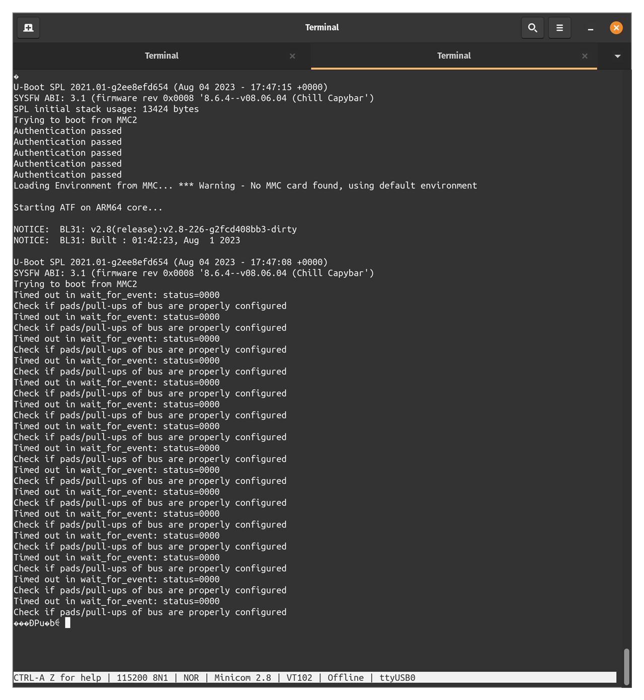

We received our first articles for a board using AM6231ATCGHAALW. Software-wise we're using SDK version 08.06.00.42 and we're having trouble in the u-boot porting step (as outlined in the am62x linux academy).
Chapter 4 is Porting LInux to Custom hardware and the first step is Porting u-boot. We're started with the DTS and defconfig files for the EVK and begun 4.1.2.2 Porting Custom Board with Minimum Configuration. In this section we've applied the DDR timings to the device tree and are working to establish our minimal pinmux setup for the custom board.
Unfortunately we've not had success getting to the u-boot prompt. We're not sure if things are halting in the R5 SPL or somewhere else and have not had any luck with the Debugging SPL section in the SDK documentation. We have J-Link debuggers but initialization scripts for AM62x do not exist and the TI JTAG emulator appears to be backordered everywhere.
Any assistance troubleshooting will be greatly appreciated.

  • Hi Judith,
    When I wrote this I wasn't getting a boot log, I was only able to see bus activity for the SD card. I've since went and rebuilt all bootloader stages and ensured I was using the HS_FS images with our DDR timings. I have SPL logs now, but for some reason u-boot is trying to read the environment/next stages from MMC2.
    MMC0 -> eMMC which is currently blank
    MMC1 -> SD card which we're using for bringup
    MMC2 -> CC3300 WiFi
    I'm currently trying to understand the reason for the references to MMC2
  • Hi Graham,
    On AM62x Processor SDK, MMC2 is SD card, see log below:

  • All right I'll consider the MMC2 message a red herring, then.
    The only change's I've made to u-boot are:
    • modify arch/arm/dts/k3-am62x-sk-ddr4-1600MTs.dtsi to use output from SysConfig for our DDR part
    • add #define DEBUG to several files and add a couple more debug() lines to a few files
    • disable a couple of SPI flash drivers because adding #define DEBUG made the R5 SPL too large

    Comparing boot logs, I'm not seeing the ATF logs you showed and my issues look to arise before the tispl "Authentication Passed" lines
    U-Boot SPL 2021.01-00001-g45cb7e44ae-dirty (Aug 07 2023 - 16:45:59 -0700)
    SYSFW ABI: 3.1 (firmware rev 0x0008 '8.6.4--v08.06.04 (Chill Capybar')
    SPL initial stack usage: 13424 bytes
    SPL malloc() before relocation used 0x6be0 bytes (26 KB)
    >>SPL: board_init_r()
    spl_init
    common/spl/spl.c(662): board_init_r - board_boot_order
    am625_init: spl_boot_device: devstat = 0x1643 bootmedia = 0x8 bootindex = 0
    common/spl/spl.c(556): boot_from_devices, loader: name=MMC2, i=0
    Trying to boot from MMC2
    Authenticating image at address 0x0000000000000000x
    Authenticating image of size 45801 bytes
    Authentication passed
    Authenticating image of size 421601 bytes
    Authenticating image of size 154169 bytes
    Authenticating image of size 319464 bytes
    Authenticating image of size 20785 bytes
    Unsupported OS image.. Jumping nevertheless..
    loaded - jumping to U-Boot...
    Loading Environment from MMC... *** Warning - No MMC card found, using default environment
    Starting ATF on ARM64 core...
    NOTICE:  BL31: v2.8(release):v2.8-226-g2fcd408bb3-dirty
    NOTICE:  BL31: Built : 05:06:58, Feb 24 2023
    U-Boot SPL 2021.01-00001-g45cb7e44ae-dirty (Aug 07 2023 - 17:05:41 -0700)
    SPL malloc() before relocation used 0x3440 bytes (13 KB)
    >>SPL: board_init_r()
    spl_init
    Timed out in wait_for_event: status=0000
    Check if pads/pull-ups of bus are properly configured
  • Hi Graham,
    Your ATF and OPTEE are working properly, I built my  binaries with extra options.
    Based on the following error:
    --> Check if pads/pull-ups of bus are properly configured
    It seems like a configurations error. Looking through u-boot, found this print in i2c driver, so it seems like the bus pads have not been configured for i2c and/or pull-ups are missing.
    Please look at: https://dev.ti.com/tirex/explore/node?node=A__ANjtmn.T3uPBiF9U2lCRWQ__linux_academy_am62x__XaWts8R__LATEST
    • Establish an initial minimal pinmux setup for the custom board
    • Update PMIC configuration
    • Customize console UART settings:
    I would first do the following step: Establish an initial minimal pinmux setup for the custom board since a minimal pinmux setup is needed to avoid signal conflicts that may occur when running a TI EVM pinmux configuration on a custom board that has different pinmux requirements.
    ~ Judith
  • Yeah the minimal pinmux was what I was working on when I encountered this issue.
    The i2c errors were from main_i2c1 probing for the SK's i2c gpio expander. I've gotten a u-boot prompt now and a partially booting linux kernel. I'll focus on u-boot for now.
    There's more stripping down of the device tree/defconfig and writing a board file, but at this point I have a u-boot console and a partially booting kernel.
    I dropped the RAM size, per https://dev.ti.com/tirex/explore/content/linux-academy-AM62X-8.6.0.42.v1/ch-porting/porting-uboot.html#modifying-ram-size, since we're not using a 4 Gbit RAM part. But I'm seeing error's mentioned in other E2E threads. Namely, errors related to the reserved regions

    Re: SDK example for 512MB of DDR, should we escalate that through our FAEs?
    Thank you for your patience
    I believe it is already escalated.
    For the moment it seems like the rootfs is not being mounted.

    [    1.578246] mmcblk0: mmc0:0001 S0J56X 14.8 GiB
    [    1.578504] mmcblk0boot0: mmc0:0001 S0J56X partition 1 31.5 MiB
    [    1.585807] mmc2: SDHCI controller on fa20000.mmc [fa20000.mmc] using ADMA 64-bit
    [    1.590748] mmcblk0boot1: mmc0:0001 S0J56X partition 2 31.5 MiB
    [    1.609993] mmcblk0rpmb: mmc0:0001 S0J56X partition 3 4.00 MiB, chardev (237:0)
    [    1.620724]  mmcblk0:
    [    1.627399] ALSA device list:
    [    1.630390]   No soundcards found.
    [    1.634282] Waiting for root device PARTUUID=c879998c-02...
    [    1.671302] mmc1: new ultra high speed SDR104 SDHC card at address aaaa
    [    1.678660] mmcblk1: mmc1:aaaa SC16G 14.8 GiB
    [    1.688426]  mmcblk1: p1 p2
    [    1.797508] EXT4-fs (mmcblk1p2): recovery complete
    [    1.805776] EXT4-fs (mmcblk1p2): mounted filesystem with ordered data mode. Opts: (null)
    [    1.813941] VFS: Mounted root (ext4 filesystem) on device 179:98.

    Please look at the log above. What does the "mmc part" command show for you? Does the UUID match the PARTUUID environment variable that was passed to Linux Kernel? Which in your case PARTUUID=20c65cda-02... was passed to kernel.
    ~ Judith
  • OK I first ran "mmc part" it was telling me unknown partition table type. So I reflashed my SD card using bmap-tool. Then I realized when running "mmc list" and "mmc dev" that u-boot was defaulting to the blank eMMC. (All that is to say: my UUIDs have changed since yesterday.)
    After running "mmc dev 1", "mmc part" returns the partitions and UUIDs correctly.
    If I let the boot run uninterfered or if I follow the commands you ran in your log above, the UUID matches the rootfs UUID from "mmc part"
    See attached log.
    My suspicion is that previous errors from loading/booting are the actual culprit.
    U-Boot SPL 2021.01-00001-g45cb7e44ae-dirty (Aug 30 2023 - 02:00:39 -0700)
    spl_init

    [    0.981395] Warning: unable to open an initial console.
    [    0.986886] Waiting for root device PARTUUID=ec635e3c-02...
    It seems like kernel was enable to open /dev/console:
    /* Open /dev/console, for stdin/stdout/stderr, this should never fail */
    void __init console_on_rootfs(void)
    	struct file *file = filp_open("/dev/console", O_RDWR, 0);
    	if (IS_ERR(file)) {
    		pr_err("Warning: unable to open an initial console.\n");
    		return;
    This leads back to the following:
        Establish an initial minimal pinmux setup for the custom board:
                A minimal pinmux setup is needed to avoid signal conflicts that may occur when running a TI EVM pinmux configuration on a custom board that has different pinmux requirements.
                Pinmux performed in U-Boot is usually limited to:
                    the peripherals that are directly involved in the boot process (such as GPMC, DDR, MMC, SPI, etc.)
                    an I2C module used for PMIC connectivity
                    the console UART
                The TI-provided Pin MUX Utility in SysConfig is the recommended way to generate pinmux settings for a custom board.
                Configure the desired console index using the Kconfig tool.
    What does your device tree look like for UART pinmux? Did you use SYSCONFIG tool?
    ~ Judith
  • I had left the hello world kernel device tree relatively untouched since I was focused on the u-boot errors. (I had disabled a few nodes that prevented compiling and configured the memory node for 512MB).
    The hello world device tree only has main_uart0 and main_uart1 enabled, but it needed an alias to tell the kernel that main_uart0 is /dev/ttyS2. I added that which solved the console error.
    [    0.716809] Loading compiled-in X.509 certificates
    [    0.727414] ti-sci 44043000.system-controller: lpm region is required for suspend but not provided.
    [    0.736726] ti-sci 44043000.system-controller: ABI: 3.1 (firmware rev 0x0008 '8.6.4--v08.06.04 (Chill Capybar')
    [    0.789602] omap-gpmc 3b000000.memory-controller: GPMC revision 6.0
    [    0.796124] gpmc_mem_init: disabling cs 0 mapped at 0x0-0x1000000
    [    0.804731] printk: console [ttyS2] disabled
    [    0.809240] 2800000.serial: ttyS2 at MMIO 0x2800000 (irq = 27, base_baud = 3000000) is a 8250
    [    0.818029] printk: console [ttyS2] enabled
    [    0.826480] printk: bootconsole [ns16550a0] disabled
    [    0.843775] rtc-ti-k3 2b1f0000.rtc: registered as rtc0
    [    0.849021] rtc-ti-k3 2b1f0000.rtc: setting system clock to 1970-01-01T00:00:14 UTC (14)
    [    0.959567] debugfs: Directory 'pd:53' with parent 'pm_genpd' already present!
    [    0.967302] debugfs: Directory 'pd:52' with parent 'pm_genpd' already present!
    [    0.974817] debugfs: Directory 'pd:51' with parent 'pm_genpd' already present!
    [    0.982727] debugfs: Directory 'pd:182' with parent 'pm_genpd' already present!
    [    1.001886] ALSA device list:
    [    1.004869]   No soundcards found.
    [    1.008759] Waiting for root device PARTUUID=ec635e3c-02...
    I enabled sdhci1 and made sure the configs matched the SK configs (wp-disable, etc). Also needed to enable the DMA controllers.
    At this point I'm getting to a login prompt and have plenty of errors to resolve. But I do want to focus back on the "memory-region errors" from u-boot and the "cma: Failed to reserve 512 MiB" from Linux

  • I have add #define CFG_PRAM (250 * 1024)  in the  file (include/configs/am62x_evm.h) .but it didn't work.
    you can see I grep CFG_PARM. it is  just used once >
    hj@hj-VirtualBox:~/ti-processor-sdk-linux-am62xx-evm-08.06.00.42/board-support/u-boot-2021.01$ grep -nR "CFG_PRAM"
    include/configs/am62x_evm.h:18:#define CFG_PRAM (250 * 1024)
    below is uboot print information
    U-Boot SPL 2021.01-00001-g45cb7e44ae-dirty (Sep 20 2023 - 10:44:01 +0800)
    20230918test:spl: mmc init failed with error: boot_device=8
    Warning: Detected image signing certificate on GP device. Skipping certificate to prevent boot failure. This will fail if the image was also encrypted
    Loading Environment from MMC... MMC Device 0 not found
    U-Boot SPL 2021.01-00001-g45cb7e44ae-dirty (Sep 20 2023 - 10:46:51 +0800)
    U-Boot 2021.01-00001-g45cb7e44ae-dirty (Sep 20 2023 - 10:46:51 +0800)
    SoC: AM62X SR1.0 GP
    Model: LICHAN-UBOOT Texas Instruments AM625 SK
    EEPROM not available at 0x50, trying to read at 0x51
    Reading on-board EEPROM at 0x51 failed 1
    DRAM: 512 MiB
    MMC: mmc@fa10000: 0, mmc@fa00000: 1, mmc@fa20000: 2
    Loading Environment from MMC... *** Warning - No block device, using default environment
    In: serial@2800000
    Out: serial@2800000
    Err: serial@2800000
    Net: eth0: ethernet@8000000port@1
    Hit any key to stop autoboot: 0
    switch to partitions #0, OK
    mmc1 is current device
    SD/MMC found on device 1
    Failed to load 'boot.scr'
    Failed to load 'uEnv.txt'
    ERROR: reserving fdt memory region failed (addr=9e780000 size=80000)
    ERROR: reserving fdt memory region failed (addr=9e800000 size=1800000)
    ERROR: reserving fdt memory region failed (addr=9db00000 size=c00000)
    19147264 bytes read in 810 ms (22.5 MiB/s)
    52276 bytes read in 24 ms (2.1 MiB/s)
    ## Flattened Device Tree blob at 88000000
    Booting using the fdt blob at 0x88000000
    ERROR: reserving fdt memory region failed (addr=9da00000 size=100000)
    ERROR: reserving fdt memory region failed (addr=9e700000 size=80000)
    Loading Device Tree to 000000008fef0000, end 000000008fffffff ... OK

  • hj@hj-VirtualBox:~/ti-processor-sdk-linux-am62xx-evm-08.06.00.42/board-support/u-boot-2021.01$ grep -nR "CFG_PRAM"
    While the above is the recommended approach given in the app note discussed earlier, there's another, perhaps better/more universal approach that can be used for the same. Can you please try removing that CFG_PRAM definition again, and implement the below patch, and report back if this makes any difference for you. Thanks!
    diff --git a/board/ti/am62x/evm.c b/board/ti/am62x/evm.c
    index 79c37b696bf1..3b6f5be47209 100644
    --- a/board/ti/am62x/evm.c
    +++ b/board/ti/am62x/evm.c
    @@ -23,6 +23,8 @@
     #include <asm/gpio.h>
     #include <cpu_func.h>
    +#include <linux/sizes.h>
     #include "../common/board_detect.h"
     DECLARE_GLOBAL_DATA_PTR;
    @@ -86,6 +88,16 @@ int dram_init_banksize(void)
     	return fdtdec_setup_memory_banksize();
    +phys_size_t get_effective_memsize(void)
    +	 * Just below 512MB are TF-A and OPTEE reserve regions, thus
    +	 * SPL/U-Boot RAM has to start below that. Leave 256MB space for
    +	 * all reserved memories.
    +	return gd->ram_size == SZ_512M ?  SZ_256M : gd->ram_size;
     #if defined(CONFIG_SPL_BUILD)
     static int video_setup(void)
    Regards, Andreas
  • it is working . my problem has solved.Thanks very much !
    for 512Ram. the gd->ram_size set to (256+128)M , it is ok .
