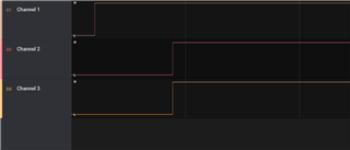

    I have a logic analyzer to check the pins. At boot, they all turn to output-high (not all at the same time though > DT= 6s, is it normal?) despite the output-low + pulldown config on gpio1_40. (Channel 1 is gpio1_40, channel 2 is gpio1_3 and channel 3 is gpio1_21)
    I have tested different inital state config (so either output-high + PULLUP or output-down + PULLDOWN) for the 3 outputs and noticed it's not working for the gpio1_40. I have seen that this pin is muxed with gmpc0_A12. Can that be a problem ?

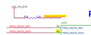

    I looked at the schematics (PROC101C (004) sheet 27) and the gpio1_40 which is also PRG0_MDIO0_MDIO (P2) is directly connected to a 2.2K pull-up resistor
    This explains why the output-low + PULLDOWN config was not working. And maybe also why it was taking the high state as soon as the board was powered unlike the other gpios. With that pin being hard-wired like this, do you think there can be a turnaround to set it to outout low at boot ?

    After discussing internally, it is recommended to use an external pull down resistor to get the signal low prior to boot.
    -Anshu
