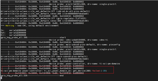

Hi TI experts,
ENV  : RTOS8.4 & not evm board
When debugging the usb device and found that the usb device could not be detected.  There some questions and please help me to figure it out.
Q1:Is the interrupt-controller0 resource allocation failed cause of the failure of the USB detected?
Q2: interrupt-controller0 resource allocation failed  seems to be related to SCI.We found through searching the code that the actual error was reported in ti_sci_get_resource_range() function in the ti_sci. c file.But I still can't understand what caused it get reource range failed?And what this annotation( /* Neither of the two resource range is valid *//* Neither of the two resource range is valid */means?
Q3:The USB driver seems to be loading normally. However, by checking the dmesg, only USB 1 and USB 2 are initialized, and there is no initialization information for USB 3 and USB 4.
What conditions do USB 3 and USB 4 meet to initialize properly?

  • Hi
    Can you share the full logs along with the dtb you used ?
    Diwakar
  • Hi Diwakar,
    Please refer to the uploaded file.

    [    0.804838] ti-sci-intr bus@100000:interrupt-controller0: Destination irq resource allocation failed
    [    0.814180] ti-sci-intr: probe of bus@100000:interrupt-controller0 failed with error -22

    1)Please forget the failed for interrupt-controller0, we had fixed it but the usb device still unable to be detected.
    2)We found that there are some new error message when uboot start up.
    According to psdkla/board-support/k3-image-gen-2022.01/include/soc/j721e/devices.h file, number 288 is  defined as
    J721E_DEV_USB0.We believe that this is the fundamental reason why USB devices ubable to be detected.But what will cause
    ti_sci_power_domain_on:get_devices(288) failed (-19)?
    Thanks & Regards.

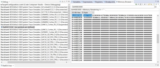

  • Hi, Diwakar,
    I read out 0x1000 registers starting from 0x44083000 through JTAG, as shown below. However, when I tried to parse the log using a Python script, I received an error message asking for version information. How should I proceed? Or, can you help us with the parsing?
    30377830

  • Hi
    I am also facing the same problem is the TRACES are from the starting of the boot ?
    Diwakar
  • Hi, Diwarkar,
    My procedure is as follows: the system is fully up and running, then i connect to MCU1_0 through JTAG, and finally, i save the registers in the CCS interface. Is there a problem with this?
    Regards.
  • HI
    Do you have a wakeup UART on the board ?
    Can you collect the TIFS traces while booting itself from the Wakeup UART?
    Diwakar
