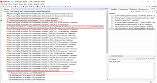

When I finished loading the symbol table, I saw the following information
Why can't I see normal function information , What causes this problem

What do you mean by normal function information? From the trace it looks like your application has already completed the execution and it is in ideal function, which is expected. If you want the CCS to halt at a specific point in your application, while you are loading the application from a Bootloader/U-boot, you can add big loops for that. Please refer the FAQ at https://e2e.ti.com/support/processors-group/processors/f/processors-forum/1121933/faq-tda4vm-debugging-sbl-boot-in-rtos-sdk

Yes, I see what you mean, but my application is working, not complete. Normal function information means that I should be able to see the call stack information for my application, but the problem is that I can only see vApplicationIdleHook

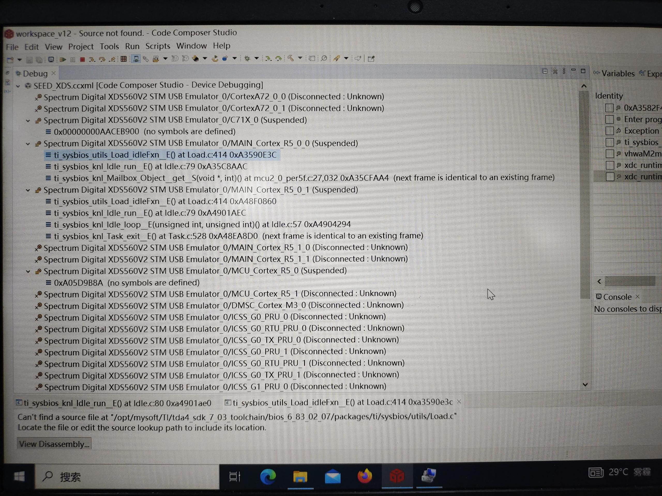

The SDK version of 0703 is normal as shown below, The issue is currently only on version 0804, so I wonder if it is due to the difference between freeRTOS and tirtos
Are you building the application in debug mode? If not, can you please try building and loading the debug version of the binary?

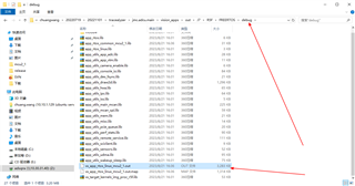

hi, i rebuild the mcu2_1 in debug mode, but i can still only see vApplicationIdleHook,

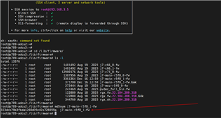

I can confirm that the program on the board is the same as the program of CCS load symbols
