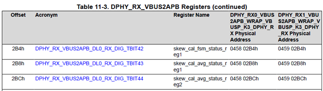

As required by MIPI D-PHY spec,

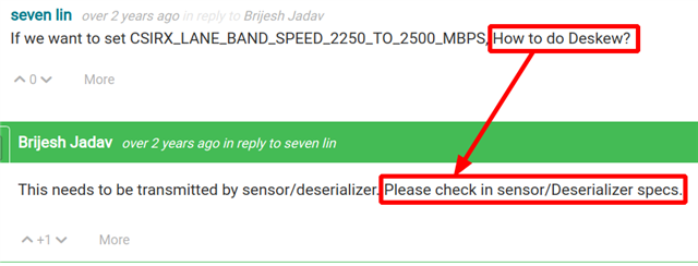

When operating above 1.5 Gbps or changing to any rate above 1.5 Gbps, an initial deskew sequence shall be transmitted before High-Speed Data Transmission in normal operation
And as mentioned in original thread, Deskew should be configurated in CSI-Tx module.
But then, how to check the Skew calibration result? It should be in CSI-Rx module: the SoC?
Thanks!
