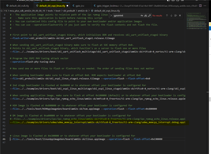

    Thanks for the project details.
    You have to follow below steps to flash R5F application on the external memory .
    1. Compile your R5F Application.
    2. Power OFF the SK and switch the SK boot mode to UART BOOT MODE.
    3. Give your R5F application app image path in yellow marked area.
    In the marked yellow position, I have given my example app image file; here you should give your R5F app image path.
    Path: C:\ti\mcu_plus_sdk_am62x_09_00_00_19\tools\boot\sbl_prebuilt\am62x-sk
    4.  Power ON the EVM and open a command prompt and run the below command to flash the Application into the External Memory.
    python uart_uniflash.py -p COM8 --cfg=sbl_prebuilt/am62x-sk/ default_sbl_ospi_linux.cfg
    Here COM<x> is the port name of the identified UART port in Windows.
     After all the flashing is done, you will see success message in command prompt window.
    5. Power OFF the EVM and switch the EVM boot mode to OSPI mode as shown below.
    Note : The above procedure is explained for the OSPI bootloader, but loading app images on an SD card is a different procedure, and that information can be get from Linux experts. Since you are exploring the device now, try to use the above procedure, and later you can switch to an SD card.
    If you are facing any file missing error throwing in flashing time, you have to compile them. Make sure that you have compile all projects in the cfg file.
    Please use this link for more details.
    https://software-dl.ti.com/mcu-plus-sdk/esd/AM62X/latest/exports/docs/api_guide_am62x/GETTING_STARTED_FLASH.html
    S.Anil.

  • 2.R5F .appimage not working startup.
    Hello veerapandiyan,
    Based on the above comments, I understand that the R5F app image is not working in OSPI boot mode.
    Can you please confirm in the 3rd point image that you have updated any applications for the R5F or the default app image you are sending ?
    One more question: as mentioned above, debugging R5F code is different as compared to M4F. and you should follow the steps below.
