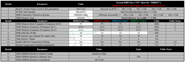

We have a custom board with DRA829V and attached Micron LPDDR4 memory.
The memory is 2GB, compared to the 4GB on the EVM development board. We have
used the Excel tool to try to get the 2GB memory working but to no avail.
Our memory is single rank. The one on the EVM is dual rank. We changed that setting
in the tool but we still get errors during the memory training:

  • FYI, the following parameters made the memory run. Don't know if it is correctly set up, but at least we
    now pass the Frequency Handshake.
    /Bo
  • Hi Bo,
    So changing the data width from 32 to 16 fixed the issue?
    This seems to indicate that there was an issue with training for the upper 16 bits (channel B), as the part number you provided does appear to have 32x data bits.

    I seems our build system is the root cause of this memory issue. We based our custom board build upon the SK-EVM files (dts, dtsi) and it didn't pass the training.
    When I made a test using the common-proc-board.dts as a base, it worked, and I assumed it was because of the parameter changes I had made in the Excel tool. I just tested with the normal parameters, and just changed the rank from 2 to 1 and it works as well for our 2GB memory.
    Now we need to figure out what caused this, and why it doesn't work with the SK files as a base.
  • Hi Bo,
    Ok thanks for the update. In terms of DDR configuration, I believe the SK files have different IO settings compared to the EVM. I am not sure what else may be different in the device tree files which would have caused the issue.
