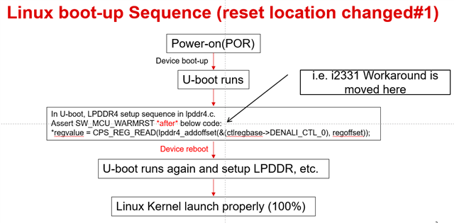

  • Hi Judith,
    The customer did DDR stress test using memtester and confirmed there is no error, so currently DDR related issue is pushed aside.
    Instead, the customer found applying MCU_PORz always solved the issue.
    Here is the scenario.
    1) The system power-up and MCU_PORz is released.
    2) Software warmreset (SW_MCU_WARMRSTz) is asserted for Errata i2331 workaround as you can see in the boot log.
    3) In case the issue happens, u-boot stops here, otherwise u-boot is executed and Linux boot-up properly.
    4) If the issue happens and u-boot stops, MCU_PORz is asserted here by driving the pin low externally then MCU_PORz is released.
    5) Boot process is repeated again.
    6) Software warmreset ((SW_MCU_WARMRSTz) is done for Errata i2331 workaround.
    7) U-boot never stops in this case. Linux always boot-up properly.
    It seems there are some differences in conditions at Step#1 and Step#4 above.
    The customer checked power supply sequence and clock status, but they are all OK.
    Thanks and regards,
    Koichiro Tashiro

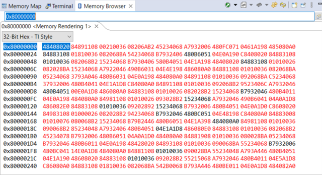

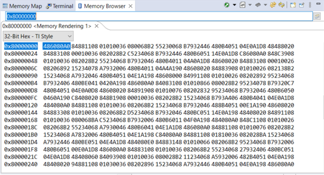

  • Koichiro, in step 4, can the customer connect with JTAG and observe a memory window in DDR address space 0x80000000?  I just want to see if DDR memory is stable at this point.  They can either enable continuous refresh or try to peek/poke values.
    James
  • Hi James,
    Yes. The customer can read/write DDR memory at 0x8000:0000.
    They did some tests with various reset sources and found below points.
    a) After the issue happens, asserting MCU_PORz recovers the system completely. No u-boot hang happens after MCU_PORz. (I reported it yesterday.)
    b) They tried to add SW resets *before* the issue happens. And it worked. The issue never happens if below changes are made in /common/spl/spl.c.

    The customer narrowed down where is the latest location to put SW_MAIN_WARMRST to workaround the issue.
    Inside drivers/ram/k3-ddrss/lpddr4.c, there is function lpddr4_startsequencecontroller() and lpddr4_readreg().
    If SW_MAIN_WARMRST is done *before* the line:
    CPS_REG_WRITE(&(ctlregbase->LPDDR4__START__REG), regval);
    this is inside lpddr4_startsequencecontroller(), the issue still occur after system re-boot.
    If SW_MAIN_WARMRST is done *after* the line:
    *regvalue = CPS_REG_READ(lpddr4_addoffset(&(ctlregbase->DENALI_CTL_0), regoffset));
    this is inside lpddr4_readreg(), the issue never occurs after system re-boot. So it can work as workaround.
    And it may sound strange, but in case SW_MAIN_WARMRST is done anywhere between above two lines, the system locks up.
    ("between" means code sequence, not just line# in text editor)
    This lock up occurs all boards, so I guess we cannot assert SW_MAIN_WARMRST here.

  • One minor question regarding that u-boot function, is it blocking? As in if you call do_reset(), will it return back to the calling function or will it while(1) and not return?
  • Hi Lucas,
    I am not sure I understand your question correctly.
    The do_reset() does SW_MCU_WARMRST, so the device re-boot.
    I summarized code sequence in each scenario in attachment.
    sequence details.pptx
    Thanks and regards,
    Koichiro Tashiro

  • Hi Tashiro-san,
    looks like an important clue is also in one of the slides you prepared...
    ...I wonder why the additional access to ctlregbase->DENALI_CTL_0 which is done in the function lpddr4_startsequencecontroller() would have an impact here in terms of working/not working.
    Will need James' input on that; it's a very specific topic, and the TRM doesn't have the needed level of detail here to understand the logs as well.
    Regards, Andreas
  • Koichiro, i compared the two regdumps, and i only see slight differences in training results (which is expected each time the training sequence is run).  So both regdumps show acceptable training results, and the DDR memory should be accessible.
    Did you say that in a failed case, the LPDDR4 shows all zeros?  If so can you run that experiment again:
    -Boot to failure
    -connect to A53 with CCS and perform a regdump
    -open Memory Browser and view memory at 0x80000000
    -if still showing zeros, perform a CPU reset on the A53 that you are connected to and check Memory Browser again
    No. The LPDDR4 shows random values. I will confirm it again tomorrow.
    I thought A53 cannot be accessible in a failed case. Anyway, I will check it.
    Thanks and regards,
    Koichiro Tashiro
  • Hi James,
    I checked DDR memory access in a failed case.
    A53 was not connectable. CCS reported an error.
    Error connecting to the target:
    (Error -2081 - (0:0:0))
    Device functional clock appears to be off. Power-cycle the board. If error persists, confirm configuration and/or try more reliable JTAG settings (e.g. lower TCLK).
    (Emulation package 9.12.0.00150)
    So I connected R5_0 and checked DDR memory.
    DDR memory showed random values.
    These values were updated each time the memory window was refreshed.
    Thanks and regards,
    Koichiro Tashiro
