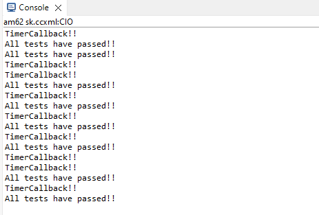

AM625: When using an MCU timer on Linux, the timer fails to trigger an interrupt
Part Number: AM625
Hello TI
  The version of SDK I use: ti-processor-sdk-linux-rt-am62xx-evm-08.06.00.42
  MCU SDK Version:mcu_plus_sdk_am62x_08_06_00_18
  I wanted to use an MCU timer and found that the timer did not trigger after configuration, here is my timer configuration.
Call in the program as follows:
I would like to know whether other configurations need to be made. I hope you can help.
