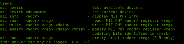

  • Hi Josue,
    After reviewing your reply and the scripts, I proceeded to connect both the TMDXIDK5718 EVM and the host Linux pc to the same network to try to boot the EVM via network.  Specifically, I took the following steps:
    1. Successfully booted and pinged the EVM from the host to make sure they are visible to each other on the network.
    2. Powered off/on the EVM to start booting off the SD card containing the embedded linux image obtained from the SDK (08-02-01-00 version).
    3. Hit a key to get u-boot menu.
    4. Selected "tftpboot" from the u-boot menu.
    5. Then, observed that ethernet PHY error: "Waiting for PHY auto negotiation to complete .............TIMEOUT!"
    6. Repeated steps 1 thru 5.  Same result.
    7. Tried the following env commands from the u-boot menu as gleaned from a related post: env default -f -a,  saveend.  Same result.  TDA4VM: Waiting for PHY auto negotiation to complete.... - Processors forum - Processors - TI E2E support forums
    Please note that ping was done to make sure host and target can see each other before attempting network boot.
    Is there a u-boot parameter that is related to the TIMEOUT?   BTW, using "tftpboot" was just a guess.  Correct guess?

  • Hi Josue,
    I went back to the starting point and re-did the following:
    1. Executed setup.sh for SDK version 08_02 on the host.  As part of the execution, setupBoard.minicom file is created, which will set the u-boot up for network booting.  This file is used in step 5.
    2. Created a bootable sd card with the default image found in SDK and inserted in the evm.
    3. Executed "minicom -w".  Note here that I am not setting the network boot in the booting done in step 3.
    4. Booted off the sd card.  login prompt displayed as expected.  But, error message indicating corrupted u-boot environment file was displayed before getting to the login prompt.  See attached.
    5. Executed "poweroff" command to power down the target evm.
    6. Executed "minicom -S ./bin/setupBoard.minicom" on the host.  This file will set the u-boot for network boot.
    7. Booted off the sd card.  Observed setupBoard.minicom commands processed by u-boot.
    8. Then, observed that ethernet PHY error: "Waiting for PHY auto negotiation to complete .............TIMEOUT!"
    Please review and let me know if you spot error on my part.  I found environment corrupt error with the pre-loaded sd card that came with the evm as well.
    PeterH.

  • Progress ...
    I've been using Ethernet 1 of the target EVM (TMDXIDK5718) up to this point.  And, it did not produce network boot.  So, I switched to Ethernet 0 and re-tested.  It worked this time.  It's not clear why so (I would appreciate your insight on this).  Either port should have worked, I'd assume.
  • Peter,
    I believe that this might be because eth 0 is the one that is set up during u-boot initialization.
    -Josue
  • How do I choose Ethernet 1?
  • Peter,
    I believe you can do this via U-boot commands, please see the open source documentation and other resources:
  • Thanks for your help!
