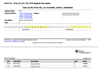

    PCIe device ID and vendor ID are defined as read-only register and are fixed. These are only to determine what kind of device is connected, and cannot be used for differentiating between two devices of the same type. For reference, here is the register description from TRM (https://www.ti.com/lit/ug/spruhz7j/spruhz7j.pdf):
    However, I am assuming the intention of wanting to change vendor/device ID is to be able to differentiate AM5706 #1 from AM5706 #2. If this is the case, then devices are usually differentiated by a combination of PCIe bus number, device number, and function number which are separate from device ID and vendor ID. For example, in Linux, there is the lspci tool which would print out something like the following:

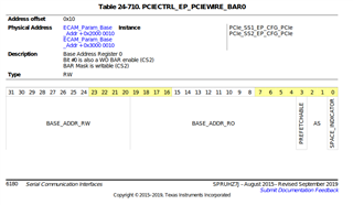

    To check if Bar 0 is being configured correctly by RC, can you check the PCIECTRL_EP_PCIEWIRE_BAR0 register on the two AM5706s and see if the values are different? For reference, the register description is on page 6180 of the TRM (https://www.ti.com/lit/ug/spruhz7j/spruhz7j.pdf):
    If Bar 0 is different between the two, we can narrow down the issue to the portion of the code that does Bar initialization. This other old E2E is pretty good at pointing out which part of the TRM is relevant for configuring Bar, so I think this can be used to see if there is a step that is being missed: https://e2e.ti.com/support/processors-group/processors/f/processors-forum/886777/am5718-about-pcie-controller-base-address-registers

    Now, coming to the problem the values of two AM5706s are same, But the  Bar 0 is not being configured correctly by RC. Although we're configuring the BAR as Memory type, The value which reflected in PCIECTRL_EP_PCIEWIRE_BAR0 tells that is IO type, attached the images for reference of PCIE_WIRE region along with DBICS and DBICS2 regions. We're in a situation now that we're really confused that where we're heading. Hoping that the attached images will give some insight to our problem, please help us in understanding the situation.

    It looks like the DBICS and DBICS2 registers are being used instead of the PCIEWIRE registers, based on the device/vendor ID registers being 0x8888 and 0x104C respectively.
    I will need to do some research on how PCIEWIRE, DBICS, and DBICS2 relate to each other. However, I have noticed in one of the screenshots shared that the DBICS2_BAR0_MASK register has BAR_ENABLED set to 0x0. If DBICS2 is being used to configure Bar, this might need to be set to 0x1.
    For reference, here is the register field description from the TRM:
    I also see BAR0 set to 0x0000_0008, but since this is different from 0x2000_0000, and 0xB000_0000, could I get clarification on where the intended base address location is?
