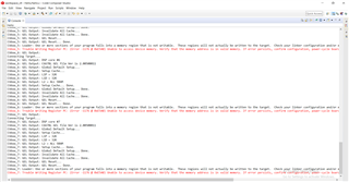

In the TMDSEVM6678L, We are facing this Target Failed error as well as Load failed.
Why is this error displayed? How to resolve it?
Please guide us to fix this error.

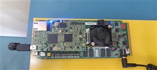

Krishn Singh Chauhan,
Post the screenshot of the errors along with your connection snapshots.
Shankari G
Before you load the sample c code program, you have to load and run the gel file which does all the initialization sequence.
Steps:-
1. create and do Test Target Configuration - Test connection should be successful before moving to next step.
2. Load and Run GEL File - Observe the out put messages of initialization sequence in the CCS console
3. Load the sample .out such as Platform_test, uart code etc.

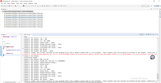

Hi Shankari G,
I followed the steps according to the previous post.
This belongs to Step 1 & 2;
GEL SETUP SUCCESSFULLY SUCCEEDED
After the Step 1 & 2 are performed.
Another error generated When We debugged the program this error displayed in the console.
Trouble Writing Register PC: (Error -1176 @ 0xE5A0) Unable to access device memory. Verify that the memory address is in valid memory. If error persists, confirm configuration, power-cycle board, and/or try more reliable JTAG settings (e.g. lower TCLK). (Emulation package 8.4.0.00006)

Hi Shankari G,
In this thread, It's only the Linker issue( which was the effect on the loader, and that's why the error was generated as per selected CORE(s)).

We mentioned below the GEL error loading details.
First, you started of this thread with loading gel file and got the errors. I suggested you how to run the gel file successfully. ( In your screenshot which shows gel error with CCS 12.4)
PLEASE NOTE, JUST TO LOAD THE GEL FILE, NO LINKER FILES ARE REQUIRED !!!
There are lot of sample programs with Processor SDK 6.3 which has all the linker files needed to compile and build successfully.
First try some platform test and run on the EVM. It is given in the Quick start guide I have pointed.
It is always necessary for us to make sure from your first step, that is all correct before you proceed to loading the ".out".
