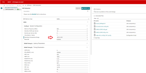

Dear TI support,
I have question to DDR config for Sitara (AM62). I’d like to know what “Operating Temperature Range” does. I believe it should set dual refresh but if I set -40C to +95C then tREFI remains the same (same value is visible in the sysconfig). But we know this setting changes several registers, so is a DRAM timing changed and if yes then which one? Does the temperature range config change tREFI register setting (7800 -> 3900 ns)?
Thanks!
Best regards
Libor

  • Hello Sreenivasa,
    the readme file for DDR config tool v9.09 says:
    " if changing Operating Temperature Range, the derating required for high temperatures will automatically be added to the appropriate parameters. However, **you must adjust tREFIab and tREFIpb manually in DRAM Timing B) section according to your memory device datasheet. You must also adjust tRASmax, as this parameter is dependent on the refresh rate** "
    I use DDR4 for AM62x and DDR4 config includes just tREFI and tRAS, so I think the manual adjustment is necessary just for some of the LPDDR4 parameters, is it correct? If I set operating temperature -40 to +95C at DDR4 config then the config tool automatically sets tREFI 3900ns in the generated files, right?
    BTW, do you know when TI plans to support the dynamic changes (Temperature-Controlled Refresh Mode)?
    Thanks!
    Best regards
    Libor

  • Hi Libor and Emanuele,
    we are in a bit of a transitional period to help support the range of temps supported by DDR.
    First for LPDDR4, i believe the v9.1 of the SDK (not released yet) will support dynamic changes (ie, temperature controlled refresh mode).  Currently, you have to choose the highest temperature you plan to operate, and configure the DDR Register Configuration Tool for that temperature.  The latest version of the tool v9.09 will automatically change the appropriate parameters when the temp setting is changed in the tool.  You will see these values change in the tool as you change the temp setting.   Since dynamic refresh rate changes aren't support yet, the tool will simply configure the refresh rate to 4x to support the higher temps.  It will also derate some of the other timings automatically, so all you should need to do is set the temp in the tool appropriately (there appears to be some typos in the README related to this, which will get fixed in the next release)
    For DDR4, it is a different story.  DDR4 doesn't have the same temp refresh mode as LPDDR4, so this is not relevant for software to support.  In the tool, you would choose the appropriate temp range for your design, and this will change MR2[7:6]= 11b to support auto self refresh mode.  MR4[3:2]  will also be changed to 11b to support temperature controlled refresh.  tREFI, tRFC, and tRAS do not automatically change, so this will need to be done by the user.  A future version of the tool will auto change the refresh rate to facilitate this.
    Hope this clears it up
    James
