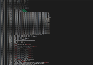

dear TI
I have some questions for you to ask at work.
Before that, let me first explain the background of the problem.
platform:TDA4 j721e
PSDK: rtos:ti-processor-sdk-rtos-j721e-evm-08_01_00_13
linux: ti-processor-sdk-linux-j7-evm-08_01_00_07
Please tell me what is the reason for this error.
    Please let me know which application are you running? Is this a out-of-the-box SDK demo or your custom demo?
    I see that the CSI logs are from MCU2_1 whereas in the SDK, it would come from MCU2_0.
    Hence, could you brief me what are the changes done in the SDK?
    Also, could you share me all the logs ( app logs + logs of "source ./vision_apps_init.sh") in .txt file?
    Nikhil
  • hi
    platform:TDA4 j721e
    In our PSDKRA, DMPAC is allocated to mcu2_1. This is done to balance to load between mcu2_0 and mcu2_1. mcu2_1 runs capture, isp, msc, ldc, display and AEWB algorithm. mcu2_0 runs dmpac and ethernet firmware.
    Now the following error appears:
    log:

    [MCU2_1]      4.328260 s: CIO: Init ... Done !!!
    [MCU2_1]      4.328333 s: ### CPU Frequency = 1000000000 Hz
    [MCU2_1]      4.328393 s: APP: Init ... !!!
    [MCU2_1]      4.328423 s: SCICLIENT: Init ... !!!
    [MCU2_1]      4.329585 s: SCICLIENT: DMSC FW version [21.9.1--v2021.09a (Terrific Lla]
    [MCU2_1]      4.329637 s: SCICLIENT: DMSC FW revision 0x15
    [MCU2_1]      4.329673 s: SCICLIENT: DMSC FW ABI revision 3.1
    [MCU2_1]      4.329712 s: SCICLIENT: Init ... Done !!!
    [MCU2_1]      4.329739 s: UDMA: Init ... !!!
    [MCU2_1]      4.341688 s: UDMA: Init ... Done !!!
    [MCU2_1]      4.341753 s: MEM: Init ... !!!
    [MCU2_1]      4.341802 s: MEM: Created heap (DDR_SHARED_MEM, id=0, flags=0x00000004) @ da000000 of size 16777216 bytes !!!
    [MCU2_1]      4.341880 s: MEM: Created heap (L3_MEM, id=1, flags=0x00000001) @ 3640000 of size 262144 bytes !!!
    [MCU2_1]      4.341941 s: MEM: Init ... Done !!!
    [MCU2_1]      4.341968 s: FVID2: Init ... !!!
    [MCU2_1]      4.342039 s: FVID2: Init ... Done !!!
    [MCU2_1]      4.342089 s: ISS: Init ... !!!
    [MCU2_1]      4.342324 s: ISX031 in used
    [MCU2_1]      4.342443 s: ar0233 not in used
    [MCU2_1]      6.046999 s: IssSensor_Init ... Done !!!
    [MCU2_1]      6.047087 s: IPC: Init ... !!!
    [MCU2_1]      6.047187 s: IPC: 8 CPUs participating in IPC !!!
    [MCU2_1]      6.047257 s: IPC: Waiting for HLOS to be ready ... !!!
    [MCU2_1]     14.180077 s: IPC: HLOS is ready !!!
    [MCU2_1]     14.211023 s: IPC: Init ... Done !!!
    [MCU2_1]     14.598497 s: REMOTE_SERVICE: Init ... !!!
    [MCU2_1]     14.601310 s: REMOTE_SERVICE: Init ... Done !!!
    [MCU2_1]     14.601431 s: vissRemoteServer_Init ... Done !!!
    [MCU2_1]     14.601502 s: IttRemoteServer_Init ... Done !!!
    [MCU2_1]     14.601537 s: VHWA: VPAC Init ... !!!
    [MCU2_1]     14.603384 s: VHWA: LDC Init ... !!!
    [MCU2_1]     14.663893 s: VHWA: LDC Init ... Done !!!
    [MCU2_1]     14.663978 s: VHWA: MSC Init ... !!!
    [MCU2_1]     14.737078 s: VHWA: MSC Init ... Done !!!
    [MCU2_1]     14.737146 s: VHWA: NF Init ... !!!
    [MCU2_1]     14.746353 s: VHWA: NF Init ... Done !!!
    [MCU2_1]     14.746425 s: VHWA: VISS Init ... !!!
    [MCU2_1]     14.788485 s: VHWA: VISS Init ... Done !!!
    [MCU2_1]     14.788554 s: VHWA: VPAC Init ... Done !!!
    [MCU2_1]     14.788604 s:  VX_ZONE_INIT:Enabled
    [MCU2_1]     14.788636 s:  VX_ZONE_ERROR:Enabled
    [MCU2_1]     14.788664 s:  VX_ZONE_WARNING:Enabled
    [MCU2_1]     14.790592 s:  VX_ZONE_INIT:[tivxPlatformCreateTargetId:54] Added target IPU1-0
    [MCU2_1]     14.790841 s:  VX_ZONE_INIT:[tivxPlatformCreateTargetId:54] Added target VPAC_NF
    [MCU2_1]     14.791085 s:  VX_ZONE_INIT:[tivxPlatformCreateTargetId:54] Added target VPAC_LDC1
    [MCU2_1]     14.791307 s:  VX_ZONE_INIT:[tivxPlatformCreateTargetId:54] Added target VPAC_MSC1
    [MCU2_1]     14.791576 s:  VX_ZONE_INIT:[tivxPlatformCreateTargetId:54] Added target VPAC_MSC2
    [MCU2_1]     14.791889 s:  VX_ZONE_INIT:[tivxPlatformCreateTargetId:54] Added target VPAC_VISS1
    [MCU2_1]     14.792181 s:  VX_ZONE_INIT:[tivxPlatformCreateTargetId:54] Added target CAPTURE1
    [MCU2_1]     14.792467 s:  VX_ZONE_INIT:[tivxPlatformCreateTargetId:54] Added target CAPTURE2
    [MCU2_1]     14.792752 s:  VX_ZONE_INIT:[tivxPlatformCreateTargetId:54] Added target DISPLAY1
    [MCU2_1]     14.793034 s:  VX_ZONE_INIT:[tivxPlatformCreateTargetId:54] Added target DISPLAY2
    [MCU2_1]     14.793274 s:  VX_ZONE_INIT:[tivxPlatformCreateTargetId:54] Added target CSITX
    [MCU2_1]     14.793573 s:  VX_ZONE_INIT:[tivxPlatformCreateTargetId:54] Added target CAPTURE3
    [MCU2_1]     14.793855 s:  VX_ZONE_INIT:[tivxPlatformCreateTargetId:54] Added target CAPTURE4
    [MCU2_1]     14.794150 s:  VX_ZONE_INIT:[tivxPlatformCreateTargetId:54] Added target CAPTURE5
    [MCU2_1]     14.794433 s:  VX_ZONE_INIT:[tivxPlatformCreateTargetId:54] Added target CAPTURE6
    [MCU2_1]     14.794708 s:  VX_ZONE_INIT:[tivxPlatformCreateTargetId:54] Added target CAPTURE7
    [MCU2_1]     14.794998 s:  VX_ZONE_INIT:[tivxPlatformCreateTargetId:54] Added target CAPTURE8
    [MCU2_1]     14.795247 s:  VX_ZONE_INIT:[tivxPlatformCreateTargetId:54] Added target DSS_M2M1
    [MCU2_1]     14.795498 s:  VX_ZONE_INIT:[tivxPlatformCreateTargetId:54] Added target DSS_M2M2
    [MCU2_1]     14.795729 s:  VX_ZONE_INIT:[tivxPlatformCreateTargetId:54] Added target DSS_M2M3
    [MCU2_1]     14.795971 s:  VX_ZONE_INIT:[tivxPlatformCreateTargetId:54] Added target DSS_M2M4
    [MCU2_1]     14.796029 s:  VX_ZONE_INIT:[tivxInitLocal:130] Initialization Done !!!
    [MCU2_1]     14.796067 s: APP: OpenVX Target kernel init ... !!!
    [MCU2_1]     14.811834 s: APP: OpenVX Target kernel init ... Done !!!
    [MCU2_1]     14.811901 s: UDMA Copy: Init ... !!!
    [MCU2_1]     14.823183 s: UDMA Copy: Init ... Done !!!
    [MCU2_1]     14.823252 s: APP: Init ... Done !!!
    [MCU2_1]     14.823323 s: APP: Run ... !!!
    [MCU2_1]     14.823349 s: APP: Run ... Done !!!
    [MCU2_1]     15.816652 s:  VX_ZONE_ERROR:[tivxTargetKernelInstanceAlloc:115] kernel com.ti.capture has not been registered on this CPU
    [MCU2_1]     15.816729 s:  VX_ZONE_ERROR:[tivxTargetKernelInstanceAlloc:116] Please register this kernel on the appropriate target core
    [MCU2_1]     15.816796 s:  VX_ZONE_ERROR:[tivxTargetNodeDescNodeCreate:761] target_kernel_instance is NULL
    [MCU2_1]     15.918102 s: ImageSensor_RemoteServiceHandler: IM_SENSOR_CMD_STREAM_ON
    [MCU2_1]     15.918195 s: sensor: ISX031-MAX96717F stream on start ...
    [MCU2_0]     17.098837 s: Function:CpswProxyServer_setPromiscModeHandlerCb,HostId:0,Handle:a32cd97c,CoreKey:38acb7e6,mode:disable
    [MCU2_0]     17.099403 s: Function:CpswProxyServer_setPromiscModeHandlerCb,HostId:0,Handle:a32cd97c,CoreKey:38acb7e6,mode:disable
    [MCU2_1]     17.322118 s:  VX_ZONE_ERROR:[tivxTargetKernelInstanceAlloc:115] kernel com.ti.capture has not been registered on this CPU
    [MCU2_1]     17.322201 s:  VX_ZONE_ERROR:[tivxTargetKernelInstanceAlloc:116] Please register this kernel on the appropriate target core
    [MCU2_1]     17.322268 s:  VX_ZONE_ERROR:[tivxTargetNodeDescNodeCreate:761] target_kernel_instance is NULL
    [MCU2_1]     17.423411 s: ImageSensor_RemoteServiceHandler: IM_SENSOR_CMD_PWROFF
    Please tell me how to fix this error, thank you
