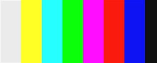

Hi TI experts,
Our test found that the last 1pixel of the image output by DSS was black bars, and we checked that the image before input DDS was normal. At present, it is not clear whether it is caused by DDS or other reasons. I hope experts can help me check whether the configuration of DDS is correct. Our image output format is NV12, resolution is 1856*750.

  • Hi Qibin su,
    I meant to ask, if the display output resolution is same input resolution? Lets says, if the display output resolution is 1920x1080 and input from the video pipeline is configured for lower resolution, like 1920x1079, then there is a possibility that there is black line at the end of the image.
    I see you are using BT601 output format from the above screen shot. Is there a possibility that vertical timing parameters are not configured correctly? or may be on the receiver side the polarity of hs or vs signals are not matching?

  • Hi Brijesh,
    We found that the entire screen is shifted forward by 1 line and the last line is filled with 80 10.
    Could you give some suggestions? If our BT601 timing setting is OK?

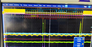

  • Hi Brijesh,
    We measured the waveform,it shows the VBP and VFP are not correct. Trying to change VBP and VFP setting like below:
    vFrontPorch 14
    vBackPorch 11
    the waveform is OK but Date we caught ,The last line is still a black line.
    the wrong waveform like below:

  • Hi Brijesh,
    We measured the waveform showed before. We set VP2 and VP3 according the below table:
    Width 1956   Width 1856
    Height 750 Height 750
    hFrontPorch 0 hFrontPorch 100
    hBackPorch 0 hBackPorch 80
    hSyncWidth 211 hSyncWidth 30
    vFrontPorch 15 vFrontPorch 15
    vBackPorch 13 vBackPorch 10
    vSyncWidth 0   vSyncWidth
    5
    The wavefore we got by measured VS in DPI is not matched the VFP 15 and VBP 10 timing. We get VFP is 16 and VBP is 9 clock in waveform.
