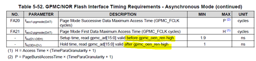

On the other hand, the datasheet(SPRS961F) specifies the hold time as gpmc_ad[15:0] valid after gpmc_oen_ren high on P203, Table 5-52, and it is only 1nsec.
It doesn’t say that 1 cycle.

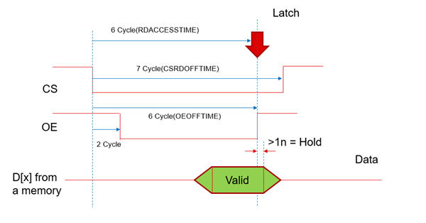

My customer’s current configuring is like the below.
RDCYCLTIME: 10
CSRDOFFTIME : 7
RDACCESSTIME: 6
OEOFFTIME : 6
Since the memory side has enough hold time(>1ns) after the rising edge of OEN, this configuration is not violate the hold requirement in the datasheet.
But RDACCESSTIME and OEOFFTIME are the same value. It looks like violating the TRM case.
They wonder if they have to modify this configuration.

    I believe that READACCESSTIME is the latch timing. Is it correct?
    I can't understand why you mentioned 1/2 FCLK delay related thing.
    Let me explain again.
    The above is the timing I assumed. The GPMC latches the data at the timing defined by RDACCESSTIME.
    The memory side remove the data output at the OE rising timing. But usually it has some hold time.
    Now RDACCESSTIME and OE rising timintg are the same.
    So if it is over 1nsec, I think it is not a problem. What is the problemn in this case? Why OEOFFTIME havre to be greather than or equal to RDACCESSTIME+1?

  • The GPMC READACCESSTIME is defined by # of FCLK cycles. It does not actually latch any data with the OEn output. However, the GPMC_FCLK is not brought out to a pin to measure setup/hold against.
  • Hello BC,
    The datasheet specifies the setup/hold timing against gpmc_oen_ren, not GPMC_FCLK like the below.
    How to think about it?
    Oba
  • Since the sampling FCLK is not available to observe on a pin, the OE signal is the closest proxy to measure setup/hold against, with the caveats and recommendations previously described in this thread.
