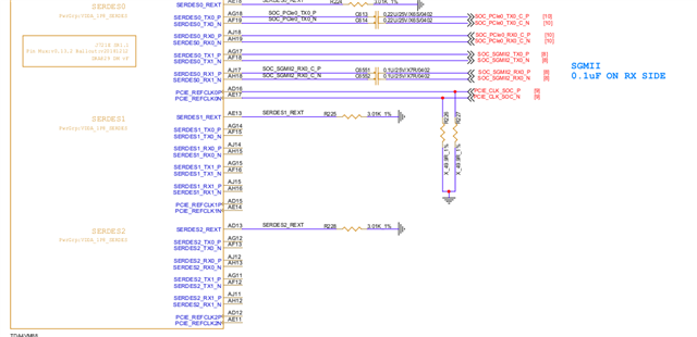

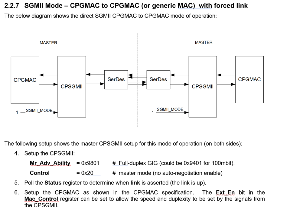

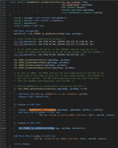

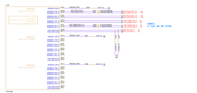

TDA4VM: TDA4VM connect to external ethernet switch through MAC-to-MAC SGMII, but port can not link up
Part Number: TDA4VM
I used TDA4VM (serdes0 lane1) to connect a externel switch by MAC-to-MAC SGMII mode. My SDK version is 08.04. My code changes as follow:
Linux DTS:

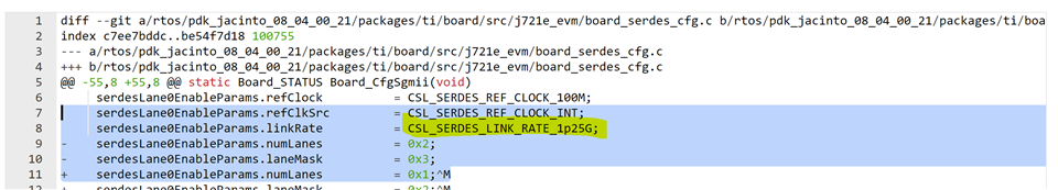

diff --git a/rtos/pdk_jacinto_08_04_00_21/packages/ti/board/src/j721e_evm/board_serdes_cfg.c b/rtos/pdk_jacinto_08_04_00_21/packages/ti/board/src/j721e_evm/board_serdes_cfg.c
index c7ee7bddc..be54f7d18 100755
--- a/rtos/pdk_jacinto_08_04_00_21/packages/ti/board/src/j721e_evm/board_serdes_cfg.c
+++ b/rtos/pdk_jacinto_08_04_00_21/packages/ti/board/src/j721e_evm/board_serdes_cfg.c
@@ -55,8 +55,8 @@ static Board_STATUS Board_CfgSgmii(void)
     serdesLane0EnableParams.refClock          = CSL_SERDES_REF_CLOCK_100M;
     serdesLane0EnableParams.refClkSrc         = CSL_SERDES_REF_CLOCK_INT;
     serdesLane0EnableParams.linkRate          = CSL_SERDES_LINK_RATE_1p25G;

    I think it is a bug. Because it checks link status before setting the mac control register. The function CpswMacPort_configSgmii is called before
    CSL_CPGMAC_SL_setMacControlReg
    No, Before MAC there is CPSGMII block which will get link status from PHY/Switch/Link Partner(if it is direct MAC).
    In MAC control we are setting EXT_EN, which will get the speed and duplexity from CPSGMII module.
    Please refer to below image for better understanding.
    CPSGMII module should get linkup from Switch in your case.

    There are some modifications as shown follow.
    (1) In the Board_CfgSgmii function, I modified the input parameters "serdesLane0EnableParams.numLanes ==> 2" of the function CSL_serdesDisablePllAndLanes.
    (2) In the CpswMacPort_configSgmii function, I still keep the changes below. If not, the port could not link up when it was configured the force mode.
    Thank you for sharing the details. It was a bug in SDK, we need to pass the Max lanes in SerDes as argument in CSL_serdesDisablePllAndLanes function call instead of num lanes enabled in SerDes.
    You change is valid one.
