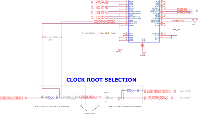

TDA4VM: clock of PCIe_M.2
Part Number: TDA4VM
Hi,Ti
      when debugging PCIe_M.2 on our custom board, we can not found ssd. So we modify TDA4VM EVM to the same as our board, and test ssd on TDA4VM EVM again, it failed.  Before modified the TDA4VM EVM can found SSD.the log as fellows:

on PCIe_M.2 we modify  CON_PCIE2_M2_REFCLK_N/ CON_PCIE2_M2_REFCLK_N  from  CLKGEN_SERDES2_REFCLK_P/CLKGEN_SERDES2_REFCLK_N to SOC_SERDES2_REFCLK_P/ SOC_SERDES2_REFCLK_N.
so we want to know how to modify dts/sdti to adapt this?

  • Hi Zhang,
    Could you try out the patches in the FAQ referenced in this E2E: https://e2e.ti.com/support/processors-group/processors/f/processors-forum/1003494/processor-sdk-j721e-how-can-i-configure-pcie-controllers-0-and-1-for-internal-clocks.
    REFCLK2 and ACSPCIe1 that are used by PCIe2 should be configured by this patch to use the internal refclk instead of external refclk.

  • Hi Davied,
    I went through 8.6 SDK and it seems like most of what the patch enables is already there. I think the only piece that is missing in the SDK, is
    • Enables differential clock buffers ACSPCIe
    • Select SERDES output as the input to the clock buffers
    from the patches that my colleague Jian posted.
    I extracted this portion from the patches and created a new patch:
    https://e2e.ti.com/cfs-file/__key/communityserver-discussions-components-files/791/0001_2D00_enable_2D00_tda4vm_2D00_pcie_2D00_internal_2D00_refclk.patch
    Could you try applying this new patch?

         We have patched the 0001-enable-tda4vm-pcie-internal-refclk.patch, and test on TDA4VM EVM and SK-TDA4VM. It doesn't work.So we think that the patch can't solve this problem.  Could you help us verify this patch on sdk 08.06.00.11?
  • Hi Davied,
    It may be that there is an issue elsewhere if the patch did not work. Could you tell me more about the setup?
    1. Is the device connected on the M.2 slot something like a NVMe SSD? In which case TDA4VM would be RC and the SSD an EP device?
    2. Could you verify in k3-j721e-common-proc-board.dts that pcie2_rc is not disabled? Please send over k3-j721e-common-proc-board.dts and k3-j721e-main.dtsi so that I can verify as well.
    3. Could you send a picture of the board modifications that has been done? I would like to verify if the correct resistors have been removed and reinstalled.
    Takuma
  • Hi, Takuma
         Thinks for your support. Now we are test patch on TDA4EVM EVM not on our custom board, it don't work. the process is as follows:
    1. Changes the CON_PCIE2_M2_REFCLK  from CLKGEN_SERDES2_REFCLK to SOC_SERDES2_REFCLK on the TDA4EVM.
    2. Patch and rebulid sdk.
    3. Copy  /lib/modules  to sdcard.
    4. Start TDA4EVM
    SSD can be recognized before those changes.the log as follows:

  • Hi Zhang,
    I reproduced the issue on my EVM. It may take me a week or longer to root cause what the issue could be. My suspicion is that some of the registers being configured in the original patch is not being configured.
    In the meantime, please let me know any debug that has been done on your end for enabling the internal clock.

  • Hi Davied,
    Apologies for the late response and thank you for your patience. For 8.6 SDK, I am having some issues that I am still working through, but for 8.0 SDK I have got the internal refclks to be routed to PCIe.
    On top of the patches in the FAQ, there needs to be a device tree change to select the core_ref_clk. In k3-j721e-main.dtsi, this core_ref_clk is selected by default, but there is an additional dts file that overwrites these default values in k3-j721e-common-proc-board.dts.
    Commenting the wiz* section out in this additional dts file like below makes the link come up on my PCIe device:
    Could you try out this change and post any logs if issues still persist?
    Takuma
  • Hi Davied,
    I resolved the issue for 8.6 SDK as well and updated the FAQ with new patches. If you get the chance, please try them out and let me know if there are further issues:
    https://e2e.ti.com/support/processors-group/processors/f/processors-forum/1004565/faq-tda4vm-tda4vm-dra829v-routing-pcie-reference-clock-externally
    Takuma
