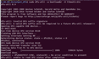

Our customer is testing the SK-AM62 evaluation board and has replaced the 2G DDR of the evaluation board with the 4G MT40A2G16.During the testing process, it was found that the following:
Unable to start using the previous SD card, switch the startup mode to USB Peripheral. After using dfu util to download tiboot3. bin to the board, it was found that the board was directly stuck and the USB port could not be connected. Unable to continue downloading files such as tiboot3. bin and u boot. img.
The SD card startup log is shown in the following figure
DFU Download Log
May I ask what is causing this exception? If DDR is replaced, does the code for uboot and kernel in the SDK need to be modified?

  • Hi,James
    Is it the following to create a new Target Configuration? If so, where can I find Launch Selected Configuration?
    Is this the file in the following image?
  • Hi,James
    I followed the instructions above and carried out the following operations. Then try to write data to the specified memory address and select SMS_ CM4_ 0_ TIFS core, which can write data to 0x80000000. Select ComputeCluster_ A53_ 0_ 0, it was found that data cannot be written to addresses 0x80000000 and 0x88000000.
    Could you please analyze the reason? Thank you!

  • It looks like you performed the steps correctly, but it appears training did not complete successfully.  Can you run the script Scripts->AM62 DDRSS Memory Debug->AM62 DDRSS CTL PI PHY and post the full results here.
    James

  • This is a memory data read and write test, displaying failure
  • Connecting to ComputeCluster for the first time_ A53_ 0_ 0 will report the following error.
  • Hi Peter, after looking at the EVM schematic (I'm looking at PROC114E3 schematic for the AM62x SK EVM), the 4GB memory you put on the board will not work.  The 4GB memory requires both BG signals (BG0 and BG1), but the schematic only shows BG0 connected (since the original DDR4 only required BG0)
    You would only be able to use half of the memory 2GB, as is on the original EVM.
    I have attached a different configuration file that should work with just the one BG signal.  But this would only allow access to 2GB address range from 0x80000000-0xFFFFFFFF
    /cfs-file/__key/communityserver-discussions-components-files/791/AM62x_2D00_DDRConfig_5F00_MT40A2G16_5F00_BG0_5F00_only.gel
    James
  • Hi James,
    After using the AM62x-DDRConfig_MT40A2G16_BG0_only.gel configuration file, I can access the 0x80000000-0xFFFFFFFF address in the CCS software. How can we convert AM62x-DDRConfig_MT40A2G16.gel files to ". dtsi" when there are BG0 and BG1 in the circuit boards we make ourselves? And then add it to uboot for use? Thank you!
    How to use gel to generate a dtsi file for DDR like the one in the following image?
  • Peter, we have a DDR Register Configuration Tool that will allow you to generate the appropriate files for u-boot  https://dev.ti.com/sysconfig/?product=Processor_DDR_Config&device=AM62x
    If you use that tool, you can generate the file BG0 only file i sent by loading the attached configuration changes into the tool
    /cfs-file/__key/communityserver-discussions-components-files/791/MT40A2G16_5F00_BG0_5F00_only.syscfg
    and then make the appropriate changes for your custom board.  To use both BG signals, you would just change the total density to 32Gb
    James
