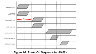

    We are using a separate power supply scheme and are currently checking the power supply timing. What we would like to know is whether there are specific requirements for the interval time between the occurrence of power rails? For example, the time interval between the occurrence of VDDSHV5 and VDDA_1P8
    Additionally, does AM6234 have some pin pins that must remain in a specific state to enter USB DFU mode?

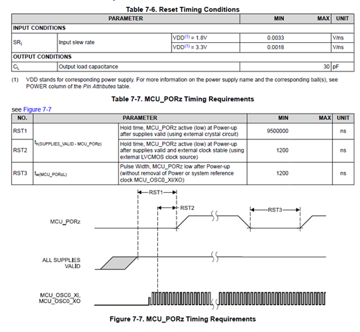

                     We are currently testing that the power supply of AM6234 can operate normally, but we are still unable to read the USB DFU port. There are several phenomena or issues that need your help to confirm, as follows:
    1. The crystal oscillator is currently not working properly. I saw in the power sequence section of the AM623 specification that the crystal oscillator will only start normally after the power supply is normal; Is it like this?
    2. We do not have power supply for VPP_1V8. I saw that VPP_1V8 is the 1.8V eFuse programming supply, I am not sure if it has any impact on this; And SOC_ VDDSHV5_ SDIO, we are currently using VCC_3V3_SYS to power it, do you know if it has any impact?
    3. I see three reset pins, all of which remain in the correct state before powering on; Are there any other pins that need to be in a specific state before being powered on?
    4. I see that in the power up sequence, the MCU_PORz will have a pull-up at the end. In the definition of the pin, it is an input pin. Currently, in our design, there is only a 4.7K pull-down. Do we need to pull it up at the appropriate time?

  • Update the Power sequence in attachment, please check.
    Compared to the power sequence of the development board, in our design, the rise time of VDDA_1V8 and VDD_2V5 is too long, and they have not yet fully risen to 1.8V, while VCC1V2_DDR has already reached 1.2V. Can this be the key reason?Power sequence.pdf

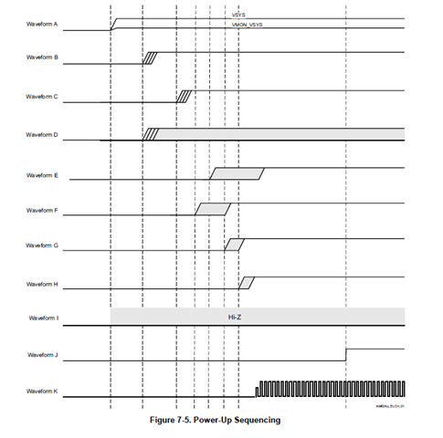

  • Hello Dengke,
    if the Oscillator is not stable please check the below power sequence and the delay between power supply ramp and MCU_PORz high.
    If the MCU_PORx is being driven by an open drain output, a pullup is required and ensure the output is zero during supply ramp.
    I am not able to understand how you are configuring the bootmode. I see a 100K pulldown but not any pullup.
    Does the I2C expander drive the bootmode configuration?
    I am not able to locate the source of VSYS supply.

  • Hello Dengke,
    I looked at the power-sequence diagram.
    I dont see the MCU_PORz timing captured after the last supply ramp.
    Please capture the MCU_PORz high timing with respect to the last supply ramp.

  • The oscillator should start within 9.5ms after all of the power supplies are valid. You are expected to hold reset low until the oscillator has started. Once all supplies are valid and the oscillator has started your reset circuit should release the device from reset by driving MCU_PORz high.
    Based on your comments above, your system has at least two problems. The first problem is the oscillator has not starting. This problem must be resolved first. The next problem is not having a reset circuit that is drives MCU_PORz high. The device will never come out of reset if the MCU_PORz pin remains low.
    Why are you creating a separate power source for VDDR_CORE. It appears you are operating VDD_CORE at 0.85V and the datasheet tells you to connect VDDR_CORE to the same source as VDD_CORE when VDD_CORE is operating at 0.85V. You only need to have a separate power source for VDDR_CORE when VDD_CORE is operating at 0.75V. This would eliminate any power sequencing concerns if you used a common 0.85V source for both.
    The device doesn't have any specific timing requirements between the power sequence ramps. The power sequencing requirements are only defined to prevent undesired potential differences between the power rails.
    Paul
