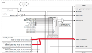

Question3:
My customer want to interrupt both CA53 and R5F generated by timer.
we could set timer for generate some interrupt?
In TRM,I think it seems if timer generated interrupt, automatically interrupt both.
TRM 12.5.3.3.2 Timers Integration in MAIN Domain
Or could we use interrupt router for generate 2 interrupt(for CA53 GIC and R5F) souced by timer interuupt?
