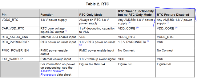

Hello, I am currently using TPS65910 PM IC for AM3352 as an internal RTC.
The new project requires the use of an external RTC Chip.
I would like to use AM3352 and RX-8025TIC as I2C communication method.
(Attach an existing circuit diagram.)
1. Remove 32.768k crystals on AM3352 IC
2. Remove backup battery on PM IC
Is it possible to use it after two operations? or Are there any other partial checkpoints?
Circuit diagram.pdf
Please reply.
Thanks!
