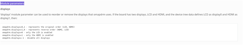

Our project is using AM5748 as main CPU, SDK is based on ti-processor-sdk-linux-am57xx-evm-08_02_01_00. We have built our own custom board and use our own build platform to build u-boot, kernel, file system, it can successfully boot up and display WEB GUI on HDMI port.
We need to implement a power-saving feature on HDMI port which can enable/disable video output from HDMI port, can anyone tell how to do it either from Linux command or an API of library?
