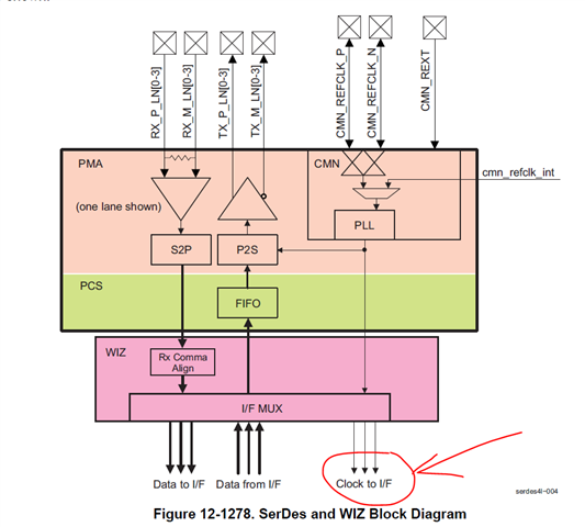

  • I'm not the PCIe subject-matter expert, but let me comment on this anyways:
    Is it okay to just change the red line in the device tree as shown in this E2E like below ?
    Are there any other file changes or settings required?
    It looks like they will also need to explicitly set that external clock to 100MHz via device tree entry, similar as shown below (on another platform):
    arch/arm64/boot/dts/ti/k3-am69-sk.dts:&serdes_refclk {
    arch/arm64/boot/dts/ti/k3-am69-sk.dts-  clock-frequency = <100000000>;
    arch/arm64/boot/dts/ti/k3-am69-sk.dts-};
    Also, the signals corresponding to <&serdes_wiz0 TI_WIZ_PLL0_REFCLK>, <&serdes_wiz0 TI_WIZ_PLL1_REFCLK>, <&serdes_wiz0 TI_WIZ_REFCLK_DIG>; are not found in TRM. What is it setting ?
    See...
    a0797059@dasso:~/git/linux (ti-linux-6.1.y)
    $ cat include/dt-bindings/phy/phy-ti.h
    /* SPDX-License-Identifier: GPL-2.0 */
     * This header provides constants for TI SERDES.
    #ifndef _DT_BINDINGS_TI_SERDES
    #define _DT_BINDINGS_TI_SERDES
    /* Clock index for output clocks from WIZ */
    /* MUX Clocks */
    #define TI_WIZ_PLL0_REFCLK      0
    #define TI_WIZ_PLL1_REFCLK      1
    #define TI_WIZ_REFCLK_DIG       2
    /* Reserve index here for future additions */
    /* MISC Clocks */
    #define TI_WIZ_PHY_EN_REFCLK    16
    #endif /* _DT_BINDINGS_TI_SERDES */
    Looks like they are clocks from the SERDES MUX (WIZ Module) that are shown in the TRM here:
    Actually, the PCIe configuration had been completed before this change was made. They want to know what this change means.
    Sorry I don't understand this statement. Are you saying PCIe worked for them before, even without any DTS changes (to accommodate the external ref clock) at all?
    Regards, Andreas
