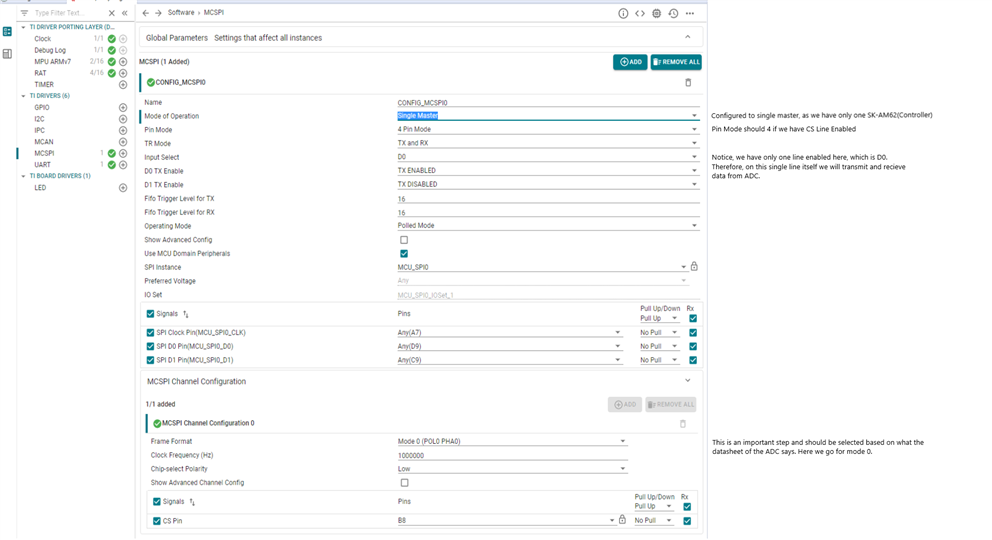

I am currently trying to setup an SPI communication on the AM62 MCU:
SPIO (CLK@A7, MOSI@D9, CS1@B8) with 100kHz
Where the Slave always responds with a 15bit data value on a read from Master.
Can you give some advice on how to setup the Sysconfig, ChConfig (if necessary) and transaction?
I tried to alter the "mcspi_loopback" example but it fails with status 3 (transaction failed)
Clemens

  • Hi Clemens,
    I have attached below an image of MCPSI SysConfig. On the right hand side you can see the important things you need to know to configure MCSPI with any slave.
    Next up we have code, so lets focus on MCSPI Transaction parameters and how to configure them.
    // Initializing TX Buffer to send dummy bytes to ADC.
    gMcspiTxBuffer[0] = 1;
    gMcspiTxBuffer[1] = 0;
    // Initializing RX buffer to 0
    gMcspiRxBuffer[0] = 0;
    gMcspiRxBuffer[1] = 0;
    /* Initiate transfer */
    MCSPI_Transaction_init(&spiTransaction);
    spiTransaction.channel  = gConfigMcspi0ChCfg[0].chNum;
    spiTransaction.dataSize = 8;
    spiTransaction.csDisable = TRUE;
    spiTransaction.count    = APP_MCSPI_MSGSIZE / (spiTransaction.dataSize/8);
    spiTransaction.txBuf    = (void *)gMcspiTxBuffer;
    spiTransaction.rxBuf    = (void *)gMcspiRxBuffer;
    spiTransaction.args     = NULL;
    transferOK = MCSPI_transfer(gMcspiHandle[CONFIG_MCSPI0], &spiTransaction);
    if((SystemP_SUCCESS != transferOK) ||
       (MCSPI_TRANSFER_COMPLETED != spiTransaction.status))
        DebugP_assert(FALSE); /* MCSPI transfer failed!! */
    else
        // Printing the 16 bit data read from ADC.
        // HIGH byte is gMcspiRxBuffer[0], LOW byte is gMcspiRxBuffer[1]
        DebugP_log("Data Read is %u \r\n", gMcspiRxBuffer[0] << 8 | gMcspiRxBuffer[1]); // HIGH byte << 8 | LOW byte
    If you look closely its the TX Buffer which has been changed and then at the end we are reading the 16 bit data received from the ADC.
