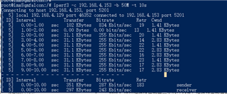

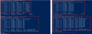

    It doesn't work as expected. 1 and 2 is the test result of iperf3 using tcp. 3 and 4 is the test result of iperf3 using udp. The ale entry and policer are in the same configuration as before.
    Is this a chip problem or a sdk problem?

    I have rechecked at our end, The packet rate sent from iperf running on PC itself is less.
    Does this mean there is no way to speed limit tcp via the chip?
    If Application is sending more than the rate limited in H/W then it will limit the packet rate as per configuration.
    As I have mentioned in TCP it was due to Handshake we are not getting the desired rate.
    Finally I would like to ask if this is a software problem or a chip problem? If it's a software problem, is it possible to fix the problem in sdk0703?
    As informed above, It is not the issue with the S/W or Chip. As pointed above PC transmission it self is lees.

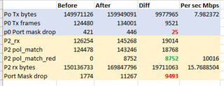

    Pease check the below data:
    Please check stats at your end as well, while running iperf in both UDP & TCP.

    When we tested it before, tda4 A72 was the receiver (iperf3 -s) and another ecu was the sender (iperf3 -c 192.168.4.153 -b 40M -t 10s). After I reversed them today, the test results did not change.
    I have two questions about the speed limit.
    First, why is it that I set pir to 20Mb,cir to 10Mb, but the test result via iperf3 about udp is only about 6Mb. Isn't the difference too big?
    Secondly, why is it that as long as pir and cir are set, the tcp sender's speed is very low, but as long as pir and cir are not set, the tested speed about tcp is the speed set by iperf3.
    It is not the issue with the ECU or chip.
    As TCP Is handshake mechanism, iperf application iself not pumping the data while negotiation with client, also you can observe the retries in case of TCP.
    If you are sending custom TCP packet without using standard applications like iperf then you can able to observe the rate liming from chip.
    Can you check the throughput using the CPSW stats it might be close to 10Mbps + 1/2Mbps as these are bits per second but drop will be in packets, If you are sending small size packets with then you may be observe the throughput close to it.
    Also, even when you are setting pir 20Mb the frames after 10Mbps are marked as yellow, as per your setting yellow also dropped so your throughput is limited to 10Mbps (10M bits per second)

    As we see UDP case we are almost getting 8Mbps throughput.
    I tested udp using the iperf3 parameter -l, changing the packet size. but the best test result was about 7M. This is still a bit different from the cir 10M. Can you recommend the parameters that should be set for -l (iperf3 --c 192.168.4.153 -b 40M -t 10s -l 1000) ?
    As we can see 8Mbps is achieving with UDP, as per internal discussion dropping of packets not at exactly choppy when huge data is receiving so, you may get some difference.

    I have tested it and the result is as follow:
    The first picture is tda4vm and the second is another ecu. The statistic is as follow:

    Lei
    I could see ~8Mbps throughput from the CPSW statistics, also some Port Mask drop in your case.
    Please refer to below.
    Sudheer
    The rate limit is 10Mbps but the test result is 8Mbps through the CPSW statistics. I think the gap is is still a bit wide. Is there something wrong with my settings, or is there something wrong with this sdk0703?
    I don't know why some Port Mask drop in my case. Even with the addition of these few dropped packets, this rate is still about 8Mbps.
