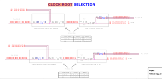

SK-TDA4VM: Wrong configuration of PCIe in TDA4VM SK board, QNX BSP
Part Number: SK-TDA4VM
Other Parts Discussed in Thread: TDA4VM,
In the TDA4VM SK board, the SOC and the PCIe device connector are connected to a common clock from clock generator (U64).
But the startup code in the BSP downloaded from QNX Software center is configuring the PCIe module to generate the reference clock to PCIe device. Even though the HW and SW configurations are not matching, the PCIe device is getting detected randomly few times (approx 1 in 20 times).
Ref code: \ti-j721e-tda4vm-sk\src\hardware\startup\boards\j721e\sk\hw_init.c
/* REFCLK_DIG_SEL = pma_cmn_refclk_int */
out32(serdes_base_address + CSL_SERDES_RST, in32(serdes_base_address + CSL_SERDES_RST) | CSL_SERDES_RST_REFCLK_DIG_SEL);
/* PLL0_REFCLK_SEL: Selects pma_cmn_refclk_int as reference clock source */
out32(serdes_base_address + CSL_SERDES_RST, in32(serdes_base_address + CSL_SERDES_RST) | CSL_SERDES_RST_PLL0_REFCLK_SEL);
/* PLL1_REFCLK_SEL: Selects pma_cmn_refclk1_int as reference clock source. */
out32(serdes_base_address + CSL_SERDES_RST, in32(serdes_base_address + CSL_SERDES_RST) | CSL_SERDES_RST_PLL1_REFCLK_SEL);
pcie_refclk_to_io(CTRL_MMR0_CFG0_BASE, serdes_id, serdes_id);

Please help us in configuring the PCIe registers correctly, for this common ref clock configuration (SOC to use the ref clock on PCIe RefClk2P and RefClk2N pins).
Also lets us know if something can be done in HW as well to resolve the issue.
  • Hi Rajashekar,
    For hardware changes, one option would be to change out the resistors such that the clocks are not received from the clock generator:
    Schematics (SCH file) and assembly (ASSY file) to locate where these resistors are can be found under the section "Design Files" of the SK-TDA4VM page: https://www.ti.com/tool/SK-TDA4VM.
    As for software, I am not too familiar with the QNX PCIe code. However, in the Linux driver that TI provides, to enable PCIe to use the refclk provided from SoC, the patches in this FAQ can be used as reference: https://e2e.ti.com/support/processors-group/processors/f/processors-forum/1004565/faq-tda4vm-tda4vm-dra829v-routing-pcie-reference-clock-externally. Theoretically, doing the opposite should disable refclk provided from SoC.
    For specifics, contacting QNX/Blackberry may be the best route, since support for PCIe driver for QNX comes directly from QNX: https://e2e.ti.com/support/processors-group/processors/f/processors-forum/1276892/tda4vm-eanable-pcie-and-detect-nvme-drive-in-tda4vm-evm-with-qnx-7-1/4838593?tisearch=e2e-sitesearch&keymatch=qnx%2520pcie#4838593. And there is a chance that QNX might have some patches for using external clock generator.
    Takuma

  • Hi Rajashekar,
    1. In the screenshot I posted above, CLKGEN (the external clock) is connected to the PCIe slot and SoC, and the connection between the external clock and SoC is disconnected (DNI = Do Not Install).
    The FAQ linked is for driving from SOC clock. The intention for sharing this was to give a reference on which registers are affected from changing between external clock to SOC clock. The use case we want now is the opposite, but I thought this was a good reference to have.
    2. If there is a mixture of clocks, then it might be the reason for random detection. We should first try to fix this and see if the problem persists.
    I assume that since QNX BSP with PCIe support could be downloaded, you may have a contact at QNX. But have they gotten back to you with information on whether they have a patch for using external clock generator?
    Takuma
    Query: The connection between the external clock and SoC is "NOT" disconnected. The clock generator outputs are connected to the SoC and the PCIe slot
    Please refer the below figure
    Can you please provide us the registers to be configured for using this external clock by the SoC (and not the internal clock)?
  • Hi Rajashekar,
    Apologies for the confusion, my wording was misleading. Yes, SoC is connected to external clock. What I meant to say is the SoC does not provide clock to the PCIe slot in the SK-TDA4VM, because CLKGEN is connected to the PCIe slot and SoC. This was to clear up the misunderstanding that "SOC does not use the above external clock (it uses internal PLL)", because SOC does use the external clock on SK-TDA4VM.
    What we can provide is reference code from our Linux SDK, but again, my recommendation is to ask QNX for a patch as support for PCIe on QNX is not supported by Texas Instruments.
    All of these registers should be findable in the technical reference manual: https://www.ti.com/lit/zip/spruil1
    Takuma

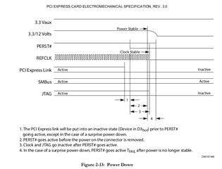

  • Hi
    Thanks for your response. We will work on your inputs.
    We have one observation in our test setup. The PCIe device is getting detected with pci-tool command in QNX , only when our board is powered off for a while and the powered ON. If we recycle the power it is not getting detected again. This we have observed multiple times.
    Can you relate this to any Hardware or software issue?
  • Hi Rajashekar,
    Some possibilities could be due to timing for power up and power down. In PCIe specification documentation, these are the signals and timing for when each signal should be initialized:
    Likewise, there is specification for power down:
    If these signals were missing some timing, then it could be the reason why after a long time of power off then PCIe devices can get detected but not if the power is cycled quickly.
    Takuma
