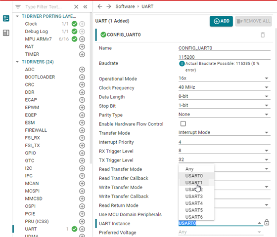

    I have made changes to k3-am642-evm.dts to use UART3 instead of UART0. I haven't tested it yet.
    I would recommend to change the UART port used the R5 application instead of changing in Linux. Taking hello world as an example, the UART port can be changed to UART1 as shown below
    Prashant
  • Hi Prashant..
    Thank you. For now I will use V8.6. Since we are in evaluation phase, should not be a issue. But a solution would be great.
    And yeah, I did the UART modification for SBL and R5 App. And both Linux and R5 applications are running. But for some reason I cannot see the console output of SBL on any of the COM Ports detected for J26 port. I can see Linux console output on UART0.

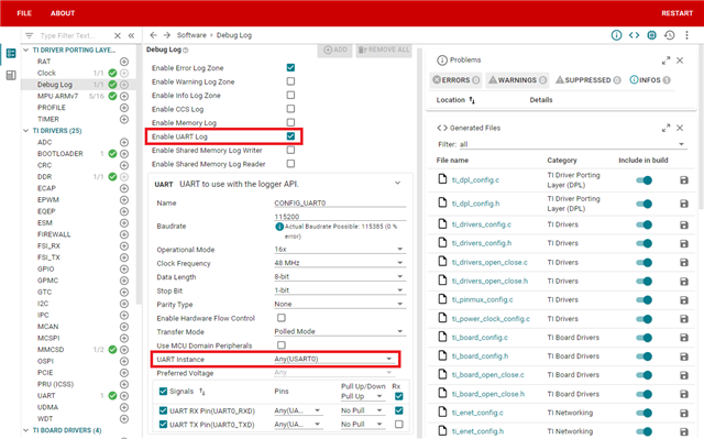

  • Hi Upendar,
    For the SBL logs, have you made sure the Debug logs are allowed to come on UART & the logging UART instance is set to maybe UART0 like so
    Prashant
  • Hi Prashant,
    UART log was already enabled. But no console output from SBL.
    Upendar
  • Hi Upendar,
    I do see the SBL logs in the very first post of this thread. So, I would like to know the changes you have done in the SBL_SD bootloader since then that resulted in the SBL logs not coming anymore. If you could share your syscfg file of SBL_SD bootloader, I can then review the settings & see if everything is in place.
    Prashant
  • Hi Prashant,
    The issue is solved. I have configured UART3 to different Pins and then it worked. (Changed UART3_RXD from U20 to D16, UART3_TXD from U18 to E16).
    Upendar
