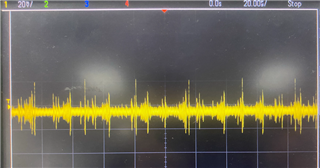

But I found an issue that I cannot measure any frequency in DSI clock lanes (both CLK_P & CLK_N). Seems they are noise here.
I think because there is no CLK from DSI, so from my endpoint, the GMSL IC cannot proceed the data.
I also want to check with the DevKit but I see that there are no test point to check the DSI clock lanes.
Could you please help share me what can be the issue here and how can I verify that?

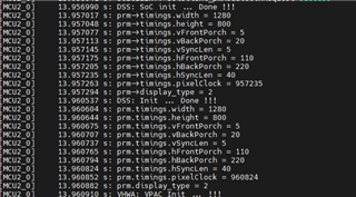

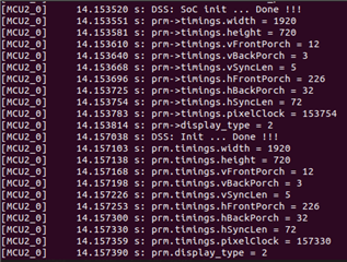

    Are you sure that DSI is enabled, and vision apps is outputting the data?
    At the moment, because there are no display so I only check by terminal log output and measure by oscilloscope.
    I checked the output log from my implement with the output log of TI Devkit when running vision_apps.
    Here is my log:

    It seems that everything is fine, I can see the DSS init logs, graph nodes, usage of CPU/Mem, the FPS value and other statistic. It quite similar when using TI DevKit.
    I also measure the data lanes by using the oscilloscope and as you can see in previous post, both P lane and N lane have quite good output here.
    So I think the camera input is OK and vision_apps already have output data.
    Also are you using continuous clock mode? Because otherwise, clock will be active only when data is sent out..
    Can you teach me how to check if I'm using continuous clock or not? I'm not sure about that.
    It is not possible that there is output on datalines, but no clock on DSI output.
    Is it require some software/hardware implement or configuration to have the DSI clock or it will enable by default? Or because my setup of measuring is not correct?
    Could you please guide me how to measure the DSI clock on TI Devkit? I checked the hardware but there are no test point here. So not really sure how to do the measure safely
    Loc.

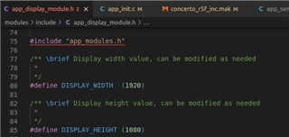

  • Hi Brijesh,
    I changed the resolution to 1280x800 in file: app_display_module.c & app_display_module.h. In the default config, I see it's 1920x1080
    But the result still the same.
    I checked by reading the register of GMSL, there are some register to check valid clock received.
    And follow the instructions from GMSL spec. The CLK_P / CLK_N of the DSI signal clock must be continuous, as non-continuous is not supported by the Serializer. This would cause no PCLKDET
    Loc.
  • Hi Loc,
    Even if we don't change DISPLAY_WIDTH/HEIGHT macros in the vision apps display module, we should see some clock activity and probably some data as well. Because DSI output will be enabled at the init time and it should start displaying background color.
    Can you please check and confirm that below parameters are used in your configuration?
    prm.timings.width = 1920U;
    prm.timings.height = 720U;
    prm.timings.vFrontPorch = 12U;
    prm.timings.vBackPorch = 3U;
    prm.timings.vSyncLen = 5U;
    prm.timings.hFrontPorch = 226U;
    prm.timings.hBackPorch = 32U;
    prm.timings.hSyncLen = 72U;
    prm.timings.pixelClock = 74250000U;
    Brijesh
  • Hi Brijesh,
    I checked the source code and see this configuration:
    platform/j721e/rtos/common/app_init.c
    I also add some logs in the app_init.c & app_dss_soc.c to check the value when performing the command "source ./vision_apps_init.sh"
    I see that the configuration here totally different with yours above. And I also found that the value of pixelClock changes every time I run the "source ./vision_apps_init.sh" command.
    I also tried apply your configuration as below:
    And the result in logs:
    Here the pixelClock also changes.
    Do you have any idea what does it mean? Does it cause any effect?
    Loc.
  • Hi Loc,
    Are you sure that you are printing it correctly?
    Because as per earlier log, it is setting up clock correctly, isn't it?
    [MCU2_0]     14.576540 s: SCICLIENT: Sciclient_pmSetModuleClkFreq module=152 clk=9 freq=74250000
    Regards.
    Brijesh
  • Hi Brijesh,
    Sorry, it's my bad, I use wrong specifiers when print this value :)
    Loc.
