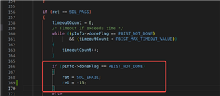

    After our long-term testing, it has been confirmed that it is caused by the BIST function.
    The log of A72, as shown in the image I sent in the message above, only appears in the first two sentences of the log.
    Guocai Yang
  • Hi Yang,
    Can you help with your boot flow? Is it reproducible on the EVM? Can you share the steps?
    Keerthy

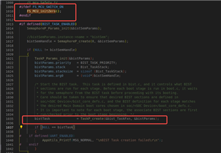

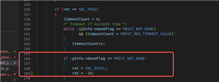

    I am searching for the current core MCU 1_ 0 the log was found to have failed during the PBIST self-test function of A72 core.
    The following is the PBIST_runTest function we use. There are no additional error messages in the printed Log, and there are only three step errors in this function without any additional error messages.

    Josiitaa
    I confirmed the error return location by setting the error return value as shown in the following figure:
    Guocai Yang
  • Could you step into the PBIST_runTest API and check at which instance, the testResult value is set to -1?
    Josiitaa
    In follow function:
    At the end, it is set to -1 at the position shown in the following figure:
    Guocai Yang
    Could you implement the changes in this patch to your code and check if you are still seeing a failure?

    You were supposed to add the SDL_TEST_osalInit() API as shown in the patch. Not just the header files.
    Josiitaa
    I checked the code and found that SDL had already been executed before enabling the BIST function_ TEST_ OsalInit() function.Are there any other modifications made?
    Guocai Yang
  • Could you clarify what you mean by SDL had been executed? You need to include SDL_TEST_osalInit at start of your PBIST_runTest API.
    Josiitaa
    I have done this function in FS_MCU_initZero(), and bist function run in bist_TaskFxn(), so I said have done SDL_TEST_osalInit before bist.
    Guocai Yang
    We have rewritten the file and function.
    Guocai Yang
    With the understanding that the SDL_TEST_osalInit is called before BIST, our next step would be to step into the SDL_PBIST_selfTest API to see what the source of the error is. You could also simultaneously run the standalone BIST example application to see if the A72 failure occurs.

    I'm sorry for the late reply. As shown in the picture I sent earlier, I'm sure it's because the variables pInfo->doneFlag were not set and not completed, the issue I identified is as shown in the following picture:
    Guocai Yang
  • HI,
    I use the bist_examples of SDL library on SDK8.6 were tested, as shown in the following figure:
    Guocai Yang
    I have understood that the flag is not sent and hence we see the failure, I would like to understand at which point within the SDL_PBIST_selfTest API the failure occurs.
