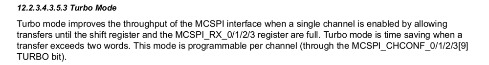

    Doing some quick research it seems like that enabling TURBO mode could bring this down further, see https://git.ti.com/gitweb?p=ti-linux-kernel/ti-linux-kernel.git;a=blob;f=include/linux/platform_data/spi-omap2-mcspi.h;h=3b400b1919a9bd8a9a446da90e37a3582af15de9;hb=refs/heads/ti-linux-6.1.y#l18 but there doesn't seem to be an easy way to turn this on as it's not exposed via DTS.
    For testing purposes, perhaps can you try the below "hack". I've not tested it myself but I hope it would result in the activation of the TURBO mode.

    yes, you got my question right. The TURBO mode sounds promising. I will test out the TURBO mode using your hack to the driver, I will let you know as soo as I've tested it.
    But I just wonder what would be the intended way to enable TURBO mode then? Is there any other API available?

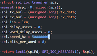

  • Some information which could be interesting for this thread:
    For some other task I was looking through some patches which have been applied to spi-omap2-mcspi driver in ti-linux repo. There I found this commit: https://git.ti.com/cgit/ti-linux-kernel/ti-linux-kernel/commit/drivers/spi/spi-omap2-mcspi.c?h=ti-linux-6.1.y-cicd&id=2cd757e6292e23b898791d71978c6edf60a251ad. It's titled: "omap2-mcspi: add support for interword delay".
    So it seems like inter-word delays are supported by the driver. Now I wonder how I can set this up as the user. For my tests I have written a small C-program which continuously sends dummy bytes over SPI using spidev API. In this program I setup the spi_ioc_transfer struct and I'm explicitly setting the entry spi_ioc_transfer.word_delay_usecs  to 0. Is this the right API to control the inter-word delays?

  • Hi Claudio,
    You can try setting it to something non-zero (something large) to see if it has any impact, this would confirm you are using the API correctly.
    This being said I doubt the default behavior would be to introduce a delay, and the user is required to set it to zero to make it go away. But rather the API can be used to introduce _additional_ delays. Otherwise this would be a really poor design IMHO.

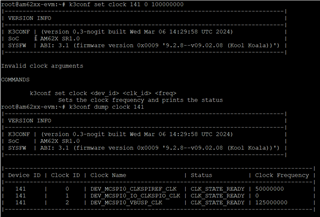

  • Hi Andreas,
    it's an interesting idea and I gave it a try. But it seems that 100MHz are not supported for this clock. After patching the dtbo as shown by you I tried the k3conf command and it still shows 50MHz Clock Frequency:
    I could confirm that dtbo was applied. Also the DMA was enabled. By looking at the MCSPI0_CLK signal I could also see no changes (still ~200ns byte gap).

  • Hi Claudio,
    Can you try the equivalent of the DTS changes but from the command line? (Again, I'm using AM62P here, so that could be why it's not working on AM62 that you have, but I'll double-check tomorrow on my AM62 board as well).
    root@am62pxx-evm:~# k3conf set clock 141 0 100000000

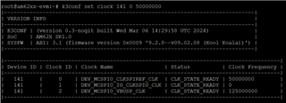

  • Hi Andreas,
    I tested to set the clock from command line but the command was giving an error:
    Actually when I try with 50MHz the command worked:
    I guess 100MHz are simply not supported by this bus.
    Regards, Claudio
  • Ah ok, thanks for trying this. Looks like a difference between AM62 an AM62P (which I used) in terms of clock tree/architecture.

    going back to this previous topic of "TURBO Mode"....
    today I could test the hack which should permanently enable SPI TURBO mode. Unfortunately from the experiment I could not see any difference when looking at the probed signals. The inter-byte gaps are still there and of same length independent of our hacked driver.
    Do you think these inter-byte gaps are coming from hardware? Or would you say we should still be able to reduce them further?
    I've since been able to experiment with this further and was able to get it to work (I think) and I've seen dramatic improvements in inter-byte gap times. Can you please go back to this page here https://e2e.ti.com/support/processors-group/processors/f/processors-forum/1356551/faq-am6x-optimizing-spi-transfer-inter-byte-gaps-using-the-dma-in-linux and review the new section I added at the end "TURBO Mode (Experimental)". Since you are a "McSPI Peripheral Power User" and are very much vested in good/fast operation of this module I would very much appreciate if you could look at this/test this one more time from your side. It all seems to work on the bench, but by no means I've done any representative real-world testing.
    Thanks, Andreas

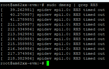

    I also observed that our patched (and Turbo Mode capable) kernel shows these errors on each boot:

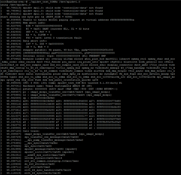

    When I then quit the demo and afterwards try executing the same SPI test program which I used in the beginning (and which was working) it will also not work anymore. So it seems that the sensor demo causes a crash inside the kernel.
    That's not good Slight smile Even let's say if things are mis-configured from a user space POV or there's some software bug the peripheral module / driver should not end up in a state it can't be recovered from.

    where tx_buf and rx_buf are both 4096 bytes and there is only the first byte set with data in tx_buf (which I'm also doing in the simple demo). However if the TX buffer would be empty the sensor demo would not receive any data from sensor since TX contains the command to request an image. Is there anything I missed? Else I unfortunately don't think this is a solution for our problem.
    Can you provide an updated spidev_test.c source file that  exhibits the the issue?

    I was reading through your article (here) more in detail now. You mention there that Turbo Mode only works in Rx only mode:
    is limited to RX-only transfers
    What exactly does this mean? In our case, as I already said earlier, we are communicating to a sensor and we need to use full-duplex mode. The communication flow is generally like this: we put an instruction byte into Tx which instructs the sensor to send data. But in the same SPI message we also expect to get the answer from the sensor into Rx. Can it be that the Tx buffer will never be filled in Turbo Mode? This could at least explain why we do not get any data from the sensor when using Turbo Mode.
    Regards, Claudio

  • Hi Claudio,
    This was based on my earlier interpretation of the Linux driver only supporting RX mode; in combination with what I think a bit unclear discussion of this feature in the User's Guide that to me also _sounded_ like it might be an RX-only feature, concluding that this is just what the HW was designed to do. However some time after that I was discussing about this with a member of our silicon/IP test team and he said it should work in both RX+TX mode and he created a proof of concept test code that showed this feature working. As a follow-on to this I enabled TURBO mode also for TX in the Linux driver and did some limited bench testing in loopback mode to confirm that RX+TX seemed to work, which is when I asked for your help to also test this in a more real-world scenario, which is when you encountered some issues. This is basically the story here.
    I still believe this feature should be something we can (and should) make work and officially available if possible. However since this is not something that can be "quickly done on the side" as part of E2E forum support I suggested we need to build a case to get the R&D team involved to properly develop, validate, and deploy (via SDK and upstream) this feature.
    Regards, Andreas

  • I also observed that our patched (and Turbo Mode capable) kernel shows these errors on each boot:
    Also, it would be great If you can share changes made in linux, that caused these messages to appear.
  • Hi Rahul,
    As I remember we were only patching the spi-omap2-mcspi.c file with the patches provided in the attachments of this site.
    Since I did these investigations long ago it will take me some time to get the entire setup running again. Please be patient, I will write here again as soon I have my setup done.
    But I also want to ask here one more time: Do you in the mean-time know where these byte gaps are coming from, and is there really no way to address these byte gaps directly? For me, the Turbo Mode seems to be more like a workaround than a real solution to this problem. And I would be more happy with a solution fixing the root cause instead of a workaround.

    - The code I was testing the SPI with is this one:
    #include <fcntl.h>
    #include <linux/spi/spidev.h>
    #include <string>
    #include <string.h>
    #include <sys/ioctl.h>
    #include <chrono>
    #define BUFF_SIZE 4096
    #define IOC_RW_API 0
    #define FIO_R_API  1
    #define FIO_W_API  2
    struct spiDev
      int fd;
      int mode = 3;
      uint8_t bits_per_word = 8;
      uint16_t delay_usecs = 0;
      uint8_t word_delay_usecs = 0;
      uint32_t speed_hz = 25000000;
      uint8_t txBuf [BUFF_SIZE] = {0};
      uint8_t rxBuf [BUFF_SIZE] = {0};
    int SPIDataRW(spiDev &spidev, int len)
      struct spi_ioc_transfer spiTransfer;
      memset(&spiTransfer, 0, sizeof(spiTransfer));
      spiTransfer.tx_buf = (uint64_t) spidev.txBuf;
      spiTransfer.rx_buf = (uint64_t) spidev.rxBuf;
      spiTransfer.len = len;
      spiTransfer.speed_hz = spidev.speed_hz;
      spiTransfer.bits_per_word = spidev.bits_per_word;
      spiTransfer.word_delay_usecs = spidev.word_delay_usecs;
      spiTransfer.delay_usecs = spidev.delay_usecs;
      // spiTransfer.cs_change = static_cast<bool>(false);
      auto start =  std::chrono::system_clock::now();
      int ret =  ioctl(spidev.fd, SPI_IOC_MESSAGE(1), &spiTransfer);
      auto end = std::chrono::system_clock::now();
      printf(
        "diff: %ims, %ius\n",
        std::chrono::duration_cast<std::chrono::milliseconds>(end - start),
        std::chrono::duration_cast<std::chrono::microseconds>(end - start)
      return ret;
    int main(int argc, char **argv)
      char *spi_devname = "/dev/spidev1.0";
      if (argc == 2) spi_devname = argv[1];
      printf("using %s\n", spi_devname);
      spiDev spidev {};
      spidev.fd = open(spi_devname, O_RDWR);
      ioctl(spidev.fd, SPI_IOC_WR_MODE32, &spidev.mode);
      ioctl(spidev.fd, SPI_IOC_RD_MODE32, &spidev.mode);
      ioctl(spidev.fd, SPI_IOC_WR_BITS_PER_WORD, &spidev.bits_per_word);
      ioctl(spidev.fd, SPI_IOC_RD_BITS_PER_WORD, &spidev.bits_per_word);
      ioctl(spidev.fd, SPI_IOC_WR_MAX_SPEED_HZ, &spidev.speed_hz);
      ioctl(spidev.fd, SPI_IOC_RD_MAX_SPEED_HZ, &spidev.speed_hz);
      printf("start sending one byte per tx (BUFF_SIZE = %i)\n", BUFF_SIZE);
      while(true)
        spidev.txBuf[0] = 0xAA; // write dummy byte
        SPIDataRW(spidev, BUFF_SIZE);
      return 0;
    You can compile it directly on target (g++ spidev.cpp -o spidev_test).

    Thanks for the information. Could you also attach vmlinux with patch applied?
    Also please attach full dmesg for both the cases you mentioned above (without ti,spi-turbo-mode in DTS and with the property added )

    Thanks for your detailed steps. We could follow all of it, and by now we are able to reproduce both the issues. Lets discuss one-by-one:
    I also figured out that, when I'm using the patched kernel (with turbo mode) and I'm not using the ti,spi-turbo-mode property in DTS, then I'm getting a kernel panic as soon as I'm running any spidev demo. So these patches are not yet robust I guess.
    Yes, if turbo mode is not enabled in dtso but enabled in kernel, this error will occur. To fix this we have modified the mcspi driver, and with this patch(attached) there will be no dependency on dtso for enabling turbo mode. It will be enabled by default in the mcspi driver. DTSO dependency is removed because turbo mode should be a enabled or not must be decided by driver itself. Please apply below change on a fresh branch of linux.

    Then I've repeated the experiments with 50MHz SPI CLK:
    - Running with SPI bus frequency of 50MHz, with DMA enabled, and with Turbo Mode disabled, I'm measuring byte gaps of about 150ns.
    - Running with SPI bus frequency of 50MHz, with DMA enabled, and with Turbo Mode enabled, I'm getting these errors again:
    I could see this error as well. Just wanted to know, did the same error appeared @25MHz(with dma + turbo)? We have started working on this to debug @50MHz(with dma + turbo).
    We are working on this with HW team. Also, the turbo mode was designed to increase throughput of spi which is the original goal here, but still we will let you know the root cause.
    Details on turbo mode: Section 12.2.3.4.3.5.3 of https://www.ti.com/lit/pdf/spruiv7b
    No, at 25MHz this error does not appear. 25MHz with DMA and Turbo was working fine in my tests.
    By now, I have finished the debugging this @50MHz. From the userspace code that you had shared, I could see that SPI transfer length is 4096. Which gets optimised by the Linux SPI framework from transfer length perspective. If the user-space SPI Transfer length goes beyond the MAX SPI transfer length which is  " 4K - 1 ", the message will be broken into multiple messages each with max size of "4K - 1"(equals to 4095).
    This 4K - 1 limit is defined in the spi-omap2-mcspi.c driver as below snippet,
    The limit 4K - 1 is fixed because of DMA capability.
    Note: AM62x uses same compatible as AM654 for mcspi.
    So the 4096 gets broken into 4095 + 1, which are 2 separate spi transfers. Where the 4095 gets transferred by DMA successfully , while the 2nd transfer of last 1 byte gets handled by PIO(polling). But since the turbo mode is enabled as well which needs the transfer length to be at least 2 bytes, this conditions fails because length is 1 byte and hence 2nd transfer doesn't take place, which you could see as RXS timed out error. Below table summarises this,
    1) Transfer length = 1 byte
        -> if turbo mode is disabled, PIO will enagage as usual and will do the transfer.
        -> if turbo mode is enabled, then this condition will not meet turbo mode which is minimum 2 bytes. And transfer will not happen.
    2) 1 byte < Transfer length < DMA_MIN_BYTES ( = 160 bytes)
        PIO(with Turbo mode) will engage
    3) DMA_MIN_BYTES <= Transfer length <=MAX Transfer length ( = 4095 bytes)
        DMA(with Turbo mode) will engage
    Our recommendation: Single SPI transfer should not breakdown into 2 separate transfers, so if possible you can go with 4095 bytes as length. Which will then transferred by DMA as a single transfer.
    Please let me know your comments on this.
    Rahul
