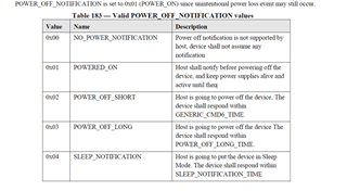

eMMC JEDC spec. has one comment  "POWER_OFF_NOTIFICATION is set to 0x01 (POWER_ON) since unintentional power loss event may still occur"
(If you have this document, pls tell me which documents decriable about this part (Table) )
Question 1 : I am not sure, why should we set 0x01 (POWER_ON) since unintentional power loss event may still occur?
Question 2 : What's our eMMC driver (or hardware) reaction when eMMC unintentional power loss? I need more information about this part.

    I Think you misinterpret the comment it is
    NOTE e•MMC device should be able to guard against sudden power loss even when
    POWER_OFF_NOTIFICATION is set to 0x01 (POWER_ON) since unintentional power loss event may still occur.
