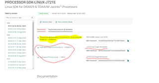

Hello all,
I have this "ti-processor-sdk-linux-adas-j721e-evm-09_01_00_06"
I flashed the sd card using the ./create_sdcard.sh shellscript, selecting the adas image.
I booted the EVM, I can see the screen, but the network does not show up correctly when I do "ifconfig"
"eth1" is missing, all I see is "eth0" and "lo" ( the lighst work on the Phy things)

If i manualy insert in the boot/root partitions the tarballs from release 08_06_01_02 ( i have to do some things in u-boot, set dorprocboot 1 )
I can see the "eth1" and I get an IP:

    From SDK 9.0 On words, default CPSW9G Virtual Mac Drivers are not loaded.
    Please refer to FAQ [How to Bring up Main Domain CPSW in Linux].
    Also refer to SDK Documentation.

  • btw: flashing the boot and rootfs from the ti website ( the 2 things bellow the .bin installer ) makes the screen not show anything. I raised a ticket for it.
    uEnv.txt you are using may not be correct, After flashing SD Card using the script.
    Update the uEnv.txt in boot with below, and update soft link for Main R5F0_0 with app remote switch server image as mentioned in FAQ pointed above.
    name_overlays=k3-j721e-evm-virt-mac-client.dtbo
    If you are facing any issue with above, please let us know.
    As SDK Is working, recommended to check with SDK Instead of file system directly.
    Sudheer
  • As SDK Is working, recommended to check with SDK Instead of file system directly.
    i did not understand this statement. Explain please.
  • HI,
    Sorry for the confusion.
    I mean use SDK release from ti product page (Highlighted Text in below)  as it was working, instead of using boor & Linux File systems (circled below) from ti product page as shown in below.
    Sudheer

    I have downloaded the SDK as shown below, and flashed SD card using create-sdcard.sh script from bin/ directory in SDK.
