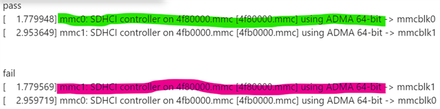

TDA4VM-Q1: TDA4VM-Q1 eMMC Boot(mmcblk0) randomly occurred that SD card(mmcblk1) occupied unexpectedly
Part Number: TDA4VM-Q1
Hi TI expert,

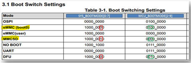

Product is default configured in eMMC boot not SD boot.
SDK version: 08.01.00.006.
Issue description:
After cold reset we sometimes met filesystem mounting fail. Because mmcblk1 initialized earlier than mmcblk0 in fail case.
Please give suggestion about this cold reset fail, thanks.
mmcblk0 & mmcblk1 initialization order:
Product boot mode is used eMMC(boot0)
Pass & fail full log

[    1.711901] printk: console [ttyS2] enabled
[    1.716669] 2840000.serial: ttyS6 at MMIO 0x2840000 (irq = 22, base_baud = 3000000) is a 8250
[    1.727396] am65-cpts 310d0000.cpts: CPTS ver 0x4e8a010a, freq:200000000, add_val:4 pps:0
[    1.736403] mmc0: CQHCI version 5.10
[    1.745878] vdd_mmc1: supplied by vsys_3v3
[    1.777267] mmc0: SDHCI controller on 4f80000.mmc [4f80000.mmc] using ADMA 64-bit
[    1.785385] tp2855 7-0021: tp2855 probed
[    1.789579] tp2855 8-0021: tp2855 probed
[    1.793799] tp2855 9-0021: tp2855 probed
[    1.797972] tp2855 10-0021: tp2855 probed
[    1.807051] tp2855_des 2-0044: Create tp2855 fault pin sysfs group successed. (kobj = (____ptrval____)),  g_priv =((____ptrval____))
[    1.818948] tp2855_des 2-0044: Successfully probed (rev/mask 00)
[    1.825362] omap-mailbox 31f80000.mailbox: omap mailbox rev 0x66fc7100
[    1.832199] omap-mailbox 31f81000.mailbox: omap mailbox rev 0x66fc7100
[    1.839007] omap-mailbox 31f82000.mailbox: omap mailbox rev 0x66fc7100
[    1.845875] omap-mailbox 31f83000.mailbox: omap mailbox rev 0x66fc7100
[    1.852693] omap-mailbox 31f84000.mailbox: omap mailbox rev 0x66fc7100
[    1.863521] ti-udma 285c0000.dma-controller: Channels: 26 (tchan: 13, rchan: 13, gp-rflow: 8)
[    1.868412] mmc0: Command Queue Engine enabled
[    1.876512] mmc0: new HS200 MMC card at address 0001
[    1.881831] mmcblk0: mmc0:0001 G1M15L 29.6 GiB
[    1.882873] ti-udma 31150000.dma-controller: Channels: 122 (tchan: 61, rchan: 61, gp-rflow: 16)
[    1.886513] mmcblk0boot0: mmc0:0001 G1M15L partition 1 31.5 MiB
[    1.901193] mmcblk0boot1: mmc0:0001 G1M15L partition 2 31.5 MiB
[    1.907237] mmcblk0rpmb: mmc0:0001 G1M15L partition 3 4.00 MiB, chardev (237:0)
[    1.915011] mmc1: CQHCI version 5.10
[    1.915812]  mmcblk0: p1 p2 p3
[    1.929467] debugfs: Directory 'pd:27' with parent 'pm_genpd' already present!
[    1.936777] debugfs: Directory 'pd:26' with parent 'pm_genpd' already present!
[    1.945059] debugfs: Directory 'pd:242' with parent 'pm_genpd' already present!
[    1.952388] debugfs: Directory 'pd:241' with parent 'pm_genpd' already present!
[    1.959701] debugfs: Directory 'pd:240' with parent 'pm_genpd' already present!
[    1.967014] debugfs: Directory 'pd:239' with parent 'pm_genpd' already present!
[    1.974973] [NVT-ts] nvt_driver_init 2169: start
[    1.979800] [NVT-ts] nvt_parse_dt 1021: novatek,irq-gpio=415
[    2.004697] [NVT-ts] nvt_bootloader_reset 389: start
[    2.076704] [NVT-ts] nvt_bootloader_reset 399: end
[    2.105025] [NVT-ts] nvt_clear_crc_err_flag 1407: BLD_SPE_PUPS (0x3F135) = 0xA5
[    2.129046] [NVT-ts] nvt_ts_check_chip_ver_trim 1498: EXT_CHIP_ID_RD (0x3F004) = 0x00, 0x00, 0x00, 0x00, 0x19, 0x05
[    2.139465] [NVT-ts] nvt_check_cascade_chip_numbers 615: CASCADE_NONE cascade_type: 0, cascade_num: 1
[    2.148664] [NVT-ts] nvt_ts_check_chip_ver_trim 1541: Non cascade case, cascade_type = 0, cascade_num = 1
[    2.158212] [NVT-ts] nvt_ts_check_chip_ver_trim 1544: This is NVT touch IC
[    2.165070] [NVT-ts] nvt_bootloader_reset 389: start
[    2.212692] [NVT-ts] nvt_bootloader_reset 399: end
[    2.228386] [NVT-ts] nvt_get_fw_info 697: Get from IC, TP FW: fw_ver=0x2, x_num=40, y_num=24, abs_x_max=1280, abs_y_max=720, max_button_num=0
[    2.241315] [NVT-ts] nvt_read_pid 646: PID (0x2A89A) = 0x1101
[    2.247107] input: NVTCapacitiveTouchScreen as /devices/virtual/input/input0
[    2.254213] [NVT-ts] nvt_ts_probe 1709: int_trigger_type=1
[    2.259816] [NVT-ts] nvt_irq_enable 119: enable=0, desc->depth=1
[    2.265827] [NVT-ts] nvt_ts_probe 1718: request irq 424 succeed
[    2.271735] [NVT-ts] nvt_ts_probe 1738: NVT_TOUCH_ESD_PROTECT is 0
[    2.277908] [NVT-ts] nvt_flash_proc_init 868: Succeeded!
[    2.283210] [NVT-ts] nvt_flash_proc_init 871: ============================================================
[    2.292844] [NVT-ts] nvt_flash_proc_init 872: Create /proc/NVTflash
[    2.299096] [NVT-ts] nvt_flash_proc_init 873: ============================================================
[    2.308733] [NVT-ts] nvt_extra_proc_init 577: create proc/nvt_fw_version Succeeded!
[    2.316374] [NVT-ts] nvt_extra_proc_init 585: create proc/nvt_baseline Succeeded!
[    2.323844] [NVT-ts] nvt_extra_proc_init 593: create proc/nvt_raw Succeeded!
[    2.330878] [NVT-ts] nvt_extra_proc_init 601: create proc/nvt_diff Succeeded!
[    2.338006] [NVT-ts] nvt_mp_proc_init 1642: create /proc/nvt_selftest Succeeded!
[    2.345389] [NVT-ts] nvt_ts_probe 1788: end
[    2.349561] [NVT-ts] nvt_irq_enable 119: enable=1, desc->depth=0
[    2.355887] [NVT-ts] nvt_driver_init 2186: finished
[    2.372695] ALSA device list:
[    2.375659]   No soundcards found.
[    2.979445] mmc1: SDHCI controller on 4fb0000.mmc [4fb0000.mmc] using ADMA 64-bit
[    2.990772] EXT4-fs (mmcblk0p1): INFO: recovery required on readonly filesystem
[    2.998106] EXT4-fs (mmcblk0p1): write access will be enabled during recovery
[    3.012589] EXT4-fs (mmcblk0p1): recovery complete
[    3.018027] EXT4-fs (mmcblk0p1): mounted filesystem with ordered data mode. Opts: (null)
[    3.026148] VFS: Mounted root (ext4 filesystem) readonly on device 179:1.

[    3.115830] mmc1: new ultra high speed DDR50 SDHC card at address 59b4
[    3.128983] mmcblk1: mmc1:59b4 USDU1 28.3 GiB
[    3.129386] NET: Registered protocol family 10
[    3.135923]  mmcblk1: p1
[    3.138343] Segment Routing with IPv6

[    4.218147] EXT4-fs (mmcblk0p1): re-mounted. Opts: (null)

[  OK  ] Found device /dev/mmcblk0p3.[    4.926500]  remoteproc1#vdev0buffer: assigned reserved memory node vision-apps-c66-dma-memory@a8000000

[    5.426458] EXT4-fs (mmcblk0p3): mounted filesystem with ordered data mode. Opts: (null)

[    1.711643] printk: console [ttyS2] enabled
[    1.716404] 2840000.serial: ttyS6 at MMIO 0x2840000 (irq = 22, base_baud = 3000000) is a 8250
[    1.727194] am65-cpts 310d0000.cpts: CPTS ver 0x4e8a010a, freq:200000000, add_val:4 pps:0
[    1.736271] mmc1: CQHCI version 5.10
[    1.745756] vdd_mmc1: supplied by vsys_3v3
[    1.779383] mmc1: SDHCI controller on 4f80000.mmc [4f80000.mmc] using ADMA 64-bit
[    1.781390] tp2855 7-0021: tp2855 probed
[    1.791144] tp2855 8-0021: tp2855 probed
[    1.795368] tp2855 9-0021: tp2855 probed
[    1.799548] tp2855 10-0021: tp2855 probed
[    1.808795] tp2855_des 2-0044: Create tp2855 fault pin sysfs group successed. (kobj = (____ptrval____)),  g_priv =((____ptrval____))
[    1.820696] tp2855_des 2-0044: Successfully probed (rev/mask 00)
[    1.827102] omap-mailbox 31f80000.mailbox: omap mailbox rev 0x66fc7100
[    1.833938] omap-mailbox 31f81000.mailbox: omap mailbox rev 0x66fc7100
[    1.840749] omap-mailbox 31f82000.mailbox: omap mailbox rev 0x66fc7100
[    1.847576] omap-mailbox 31f83000.mailbox: omap mailbox rev 0x66fc7100
[    1.854376] omap-mailbox 31f84000.mailbox: omap mailbox rev 0x66fc7100
[    1.865158] ti-udma 285c0000.dma-controller: Channels: 26 (tchan: 13, rchan: 13, gp-rflow: 8)
[    1.875612] ti-udma 31150000.dma-controller: Channels: 122 (tchan: 61, rchan: 61, gp-rflow: 16)
[    1.887933] mmc0: CQHCI version 5.10
[    1.897296] mmc1: Command Queue Engine enabled
[    1.901339] debugfs: Directory 'pd:27' with parent 'pm_genpd' already present!
[    1.901762] mmc1: new HS200 MMC card at address 0001
[    1.909021] debugfs: Directory 'pd:26' with parent 'pm_genpd' already present!
[    1.914209] mmcblk1: mmc1:0001 G1M15L 29.6 GiB
[    1.922134] debugfs: Directory 'pd:242' with parent 'pm_genpd' already present!
[    1.925820] mmcblk1boot0: mmc1:0001 G1M15L partition 1 31.5 MiB
[    1.932986] debugfs: Directory 'pd:241' with parent 'pm_genpd' already present!
[    1.939009] mmcblk1boot1: mmc1:0001 G1M15L partition 2 31.5 MiB
[    1.946179] debugfs: Directory 'pd:240' with parent 'pm_genpd' already present!
[    1.959423] debugfs: Directory 'pd:239' with parent 'pm_genpd' already present!
[    1.959449] mmcblk1rpmb: mmc1:0001 G1M15L partition 3 4.00 MiB, chardev (237:0)
[    1.974340] [NVT-ts] nvt_driver_init 2169: start
[    1.979255] [NVT-ts] nvt_parse_dt 1021: novatek,irq-gpio=415
[    1.984950]  mmcblk1: p1 p2 p3
[    2.004794] [NVT-ts] nvt_bootloader_reset 389: start
[    2.076790] [NVT-ts] nvt_bootloader_reset 399: end
[    2.105113] [NVT-ts] nvt_clear_crc_err_flag 1407: BLD_SPE_PUPS (0x3F135) = 0xA5
[    2.129133] [NVT-ts] nvt_ts_check_chip_ver_trim 1498: EXT_CHIP_ID_RD (0x3F004) = 0x00, 0x00, 0x00, 0x00, 0x19, 0x05
[    2.139551] [NVT-ts] nvt_check_cascade_chip_numbers 615: CASCADE_NONE cascade_type: 0, cascade_num: 1
[    2.148752] [NVT-ts] nvt_ts_check_chip_ver_trim 1541: Non cascade case, cascade_type = 0, cascade_num = 1
[    2.158299] [NVT-ts] nvt_ts_check_chip_ver_trim 1544: This is NVT touch IC
[    2.165157] [NVT-ts] nvt_bootloader_reset 389: start
[    2.212779] [NVT-ts] nvt_bootloader_reset 399: end
[    2.228475] [NVT-ts] nvt_get_fw_info 697: Get from IC, TP FW: fw_ver=0x2, x_num=40, y_num=24, abs_x_max=1280, abs_y_max=720, max_button_num=0
[    2.241408] [NVT-ts] nvt_read_pid 646: PID (0x2A89A) = 0x1101
[    2.247210] input: NVTCapacitiveTouchScreen as /devices/virtual/input/input0
[    2.254323] [NVT-ts] nvt_ts_probe 1709: int_trigger_type=1
[    2.259911] [NVT-ts] nvt_irq_enable 119: enable=0, desc->depth=1
[    2.265923] [NVT-ts] nvt_ts_probe 1718: request irq 424 succeed
[    2.271831] [NVT-ts] nvt_ts_probe 1738: NVT_TOUCH_ESD_PROTECT is 0
[    2.278002] [NVT-ts] nvt_flash_proc_init 868: Succeeded!
[    2.283303] [NVT-ts] nvt_flash_proc_init 871: ============================================================
[    2.292937] [NVT-ts] nvt_flash_proc_init 872: Create /proc/NVTflash
[    2.299189] [NVT-ts] nvt_flash_proc_init 873: ============================================================
[    2.308825] [NVT-ts] nvt_extra_proc_init 577: create proc/nvt_fw_version Succeeded!
[    2.316465] [NVT-ts] nvt_extra_proc_init 585: create proc/nvt_baseline Succeeded!
[    2.323936] [NVT-ts] nvt_extra_proc_init 593: create proc/nvt_raw Succeeded!
[    2.330971] [NVT-ts] nvt_extra_proc_init 601: create proc/nvt_diff Succeeded!
[    2.338096] [NVT-ts] nvt_mp_proc_init 1642: create /proc/nvt_selftest Succeeded!
[    2.345478] [NVT-ts] nvt_ts_probe 1788: end
[    2.349650] [NVT-ts] nvt_irq_enable 119: enable=1, desc->depth=0
[    2.355944] [NVT-ts] nvt_driver_init 2186: finished
[    2.372798] ALSA device list:
[    2.375762]   No soundcards found.
[    2.959525] mmc0: SDHCI controller on 4fb0000.mmc [4fb0000.mmc] using ADMA 64-bit
[    2.968016] VFS: Cannot open root device "mmcblk0p1" or unknown-block(0,0): error -6

[    3.032841]  (driver?)
[    3.038925] 0109            4096 ram9
[    3.038927]  (driver?)
[    3.045013] 010a            4096 ram10
[    3.045015]  (driver?)
[    3.051187] 010b            4096 ram11
[    3.051188]  (driver?)
[    3.057366] 010c            4096 ram12
[    3.057367]  (driver?)
[    3.063539] 010d            4096 ram13
[    3.063540]  (driver?)
[    3.069714] 010e            4096 ram14
[    3.069715]  (driver?)
[    3.075888] 010f            4096 ram15
[    3.075890]  (driver?)
[    3.082066] b300        31080448 mmcblk1
[    3.082068]  driver: mmcblk
[    3.088851]   b301         3915776 mmcblk1p1 6eb4a5f9-01
[    3.088853]
[    3.095636]   b302         3915776 mmcblk1p2 6eb4a5f9-02
[    3.095637]
[    3.102418]   b303        23224320 mmcblk1p3 6eb4a5f9-03
[    3.102419]
[    3.109202] Kernel panic - not syncing: VFS: Unable to mount root fs on unknown-block(0,0)
[    3.117448] CPU: 1 PID: 1 Comm: swapper/0 Not tainted 5.10.65-gfeff4d2e65 #1
[    3.124477] Hardware name: Texas Instruments J721E CCIDS (DT)
[    3.130205] Call trace:
[    3.132655]  dump_backtrace+0x0/0x1a0
[    3.136306]  show_stack+0x18/0x68
[    3.139611]  dump_stack+0xd0/0x12c
[    3.143000]  panic+0x16c/0x334
[    3.146046]  mount_block_root+0x2b8/0x34c
[    3.150042]  mount_root+0x70/0x80
[    3.153344]  prepare_namespace+0x130/0x170
[    3.157427]  kernel_init_freeable+0x25c/0x2a0
[    3.161771]  kernel_init+0x14/0x114
[    3.161808] mmc0: new ultra high speed DDR50 SDHC card at address 59b4
[    3.165246]  ret_from_fork+0x10/0x34
[    3.165252] SMP: stopping secondary CPUs
[    3.172100] mmcblk0: mmc0:59b4 USDU1 28.3 GiB
[    3.175334] Kernel Offset: disabled
[    3.175336] CPU features: 0x0040022,20006008
[    3.175338] Memory Limit: none
[    3.194440] ---[ end Kernel panic - not syncing: VFS: Unable to mount root fs on unknown-block(0,0) ]---
  • Hi Cloud
    Can you make the below changes in your dtsi file and see if it works now.
    aliases {
    		mmc0 = &main_sdhci0;
    		mmc1 = &main_sdhci1;
    Diwakar
  • Diwakar,
    Let's me double check one thing.
    we need to add code here.
    \k3-j721e.dtsi
    	aliases {
    		serial0 = &wkup_uart0;
    		serial1 = &mcu_uart0;
    		serial2 = &main_uart0;
    		serial3 = &main_uart1;
    		serial4 = &main_uart2;
    		serial5 = &main_uart3;
    		serial6 = &main_uart4;
    		serial7 = &main_uart5;
    		serial8 = &main_uart6;
    		serial9 = &main_uart7;
    		serial10 = &main_uart8;
    		serial11 = &main_uart9;
    		ethernet0 = &cpsw_port1;
    Try to fix mmc0 / mmc1 to MMCSDx_CTL_CFG register mapping, isn't?
    Gibbs
  • Hi Gibbs
    We are not changing any registers we are just assigning the alias name so that mmc0 is always emmc and mmc1 is sd.
    Diwakar
