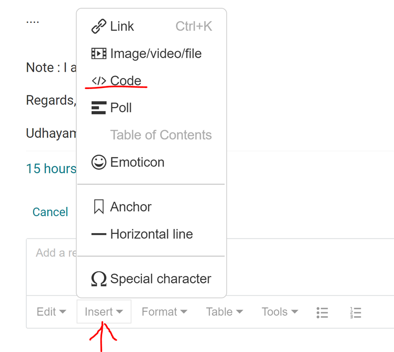

  • Hello Udhayamoorthi,
    Thanks for providing these information. Please add your code snippet or log using the Insert->code feature, as shown below:
    Regarding your question from the other thread: "I am not sure after these how to add imaging/tools/default_DCC_profile_gen/configs files ", please follow the ISP tuning guide, 6.2 Enable Camera Streaming with Initial VPAC Configuration.
