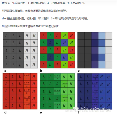

When we investigated the purple circle problem caused by enabling GLBCE, we found that if bilinear interpolation was used when demosaic was performed on bayer images (without considering the pixel value gradient), pseudo-color problems might occur near the high contrast of images, as shown in the following figure. What is the algorithm used by AM62A/TDA4 to do demosaic? Could the cause of the purple circle be related to this?

    You may find CFAI information in TDA4 TRM in the FCP section.
    It is gradient based interpolation.

  • Hi Ding,
    It looks like the issue is much more related to GLBCE than CFAI.
    The purple edge is present after GLBCE and before CFAI.
  • Hi Gang,
    Since this only happens when the bilinear interpolation de-mosaicing algorithm is used at very high contrast. I wonder if it's possible that it's the contrast enhancement by GLBCE that's causing CFAI to cause the purple edge problem. In other words, the disappearance of the purple edge problem when GLBCE is turned off is the result of a low local-contrast factor.

  • Hi Ding,
    I find the purple edge present in GLBCE output before CFAI.
    You may refer to this raw image as an example.
    /cfs-file/__key/communityserver-discussions-components-files/791/pic_5F00_1920x1080_5F00_B.raw
    It sometimes shows up as a dark band or purple circle around bright spot lights after GLBCE.
    It seems GLBCE makes a ripple in those areas (even if the brightness goes up monotonically while we go toward light center without any ripple before GLBCE).
    I don't fully understand this GLBCE's behavior as it is a 3rd party IP.
