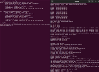

I still have the issue that if I want to use network on my QUAD ( i got a new board with the QUAD phy ethernets working) I can not use the screen, as they share the same serializer.
I need to fix this, and I need a valid solution.
Using the sdk9, i updated the uEnv to contain the overlay for virt-mac:
I have screen, but the eth1 is not showing up, the lights are showing up on the PHYs.
in sdk8 I do not have this issue.
    Can you please clarify the following;
    • For the display, are you talking about the Vision apps?
    • Is the vision app currently running on EVM?
    The display phy and network(QSGMII) link uses different serdes. Maybe you want to run vision apps binary on mcu2_0, but you are running ethfw binary.
    Can you share the output of 'ls -al /lib/firmware' and the kernel boot logs here.
    Can you also please point me to the older thread you were talking about.
    Tanmay
  • I have the sdk08, i connect the display port to a monitor, and a newtork cable to the quad phy.
    The thing boots, i stop at the u-boot:
    setenv dorprocboot 1
    saveenv,
    boot
    I have a working display ( screen, monitor, why do you asume vision apps means the same as display?)
    I have a working network.
    On SDK9, seems the network is not running at all, on the QUAD PHY, only on the other one( the litle one on the other side of the common board)
    Br, Mircea

  • Display Port 0, is what I mean by screen.
  • Hi Mircea,
    Let me check with our vision apps expert if this is a known issue or some configuration issue.
    I will respond back here tomorrow with updates.
    Tanmay
  • Hi Mircea,
    A couple of suggestions:
    • link the vision app binary to the "j7-main-r5f0_0-fw". It has the ethfw server in it.
    • For including the dtbo, please keep the order as virtual-mac dtbo first and vision apps dtbo later.
      • As both of them carve out a memory region for R5, we want to use the one carved out by vision apps
    This should work.
    One more thing, according to my understanding with vision apps the Display is blank if you do not have a display app running. just pointing this out.
    Tanmay

    YES, I do not have a display.
    As informed earlier when you have vision overlay which will disable the display node in Linux and Display driver have to be run from R5F using vision applications.
    While running the vision applications, you need to map vision binaries to R5F not EthFw binary.
    Please refer to vision apps user guide for build and running the setup.
    For Ethernet alone please refer to FAQ.
    Sudheer
