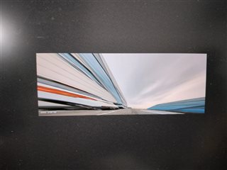

  • Hi sir,
    The input given to the display_m2m is not proper. We have a custom node before m2m node. The output of the custom node is RGB interleaved and it is dumped inside the custom node and found to be valid. Display_m2m takes this as input. In app_run_graph_for_one_frame_pipeline function, I have used API tivx_utils_save_vximage_to_bmpfile to save the input image of display_m2m. The image dumped inside the custom node and input image to display_m2m are supposed to be same but found different. Can you please guide me on this?
    Seetharama Raju.

  • I would suggest checking the output of this node. It doesn't not look like an issue in display_m2m node.
    Rgds,
    Brijesh
  • Hi sir,
    The above issue is due to the consideration of width instead of stride while reading the output image of our custom node. The issue is resolved. The application is running now. But after running the app for 2 or 3 minutes, the following log is getting appeared on the console and the app stops working. I didn't find any references in E2E. Can you please guide me on this?
