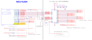

Hi TI Team,
We are seeing some strange issue while writing/reading QSPI memory connected to OSPI flash memory controller ( Interface OSPI1 )
ISSUE1: We are mounting QSPI flash partition with jffs2 filesystem and after restart we are missing few folders on the filesystem. It seems creating shorter folder names always disappear after reboot
[ 12.255126] jffs2: notice: (587) read_direntry: name CRC failed on dirent node at0x891b53c: read 0x4f61bd5,calculated 0x7a475847
[ 12.255178] jffs2: notice: (587) read_direntry: name CRC failed on dirent node at0x8919f4c: read 0x794dcb2b,calculated 0xefcb3bb7
[ 12.709506] jffs2: notice: (588) check_node_data: wrong data CRC in data node at 0x0891ce90: read 0x4f4196c7, calculated 0x9e82f6ff.
[ 12.709659] jffs2: notice: (588) check_node_data: wrong data CRC in data node at 0x0891cbf0: read 0x565aa786, calculated 0x9e82f6ff.
ISSUE2: Reading fewer bytes <10 from raw mtd partitions ends up in garbage data
Could you please
  • Review the hardware connections and let us know if there are any changes needed ?
  • Do we need to tweak any settings on the software side ?

  • Hi Swapna,
    As it is happening on all devices it looks like timing issue. Could you please check if the above information provided related to hardware schematics and device tree look correct to you?
    It seems there are some mismatches on the MCU Flash device tree in the hardware schematic you attached above when comparing it to TI's schematic.
    As shown in the screenshot above, we have a resistor attached to MCU_OSPI0_LBCLK0 and your board does not. You instead have a resistor attached to MCU_OSPI0_DQS when TI's board does not. Our board also uses a different flash which is why the rest of the schematic looks a little different, but if you want to compare and check other parts of the device tree. I have attached a link below to download TI's schematic.
    https://www.ti.com/lit/zip/sprr408
    Matt
  • Hi Matt,
    TI board has OSPI flash only our board has both OSPI Flash and QSPI Flash.
    Could you please look at MT25QU02G part above as well please?
    Swapna
  • Hi Swapna,
    I actually looked back at the schematic for the SOM + EVM and we do have the same flash parts just different capacities I believe.
    For the QSPI Flash MT25QU02G, it seems the only difference is that we don't have MCU_OSPI1_DQS and MCU_OSPI1_LBCLKO connected to anything. Whereas in your board you have it connected to some resistors.
    Matt
