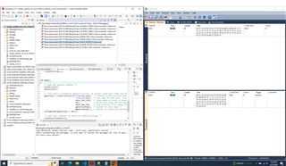

  • Hi Aparna,
    I checked and screen record my output below i attached the file
    ccs checking video Link: drive.google.com/.../view
    I upload video link for terminal output is AM62x GP board, AM62B-P board also same error is came.
    Terminal output Video Link : https://drive.google.com/file/d/1QgOrn6M-yMbvtdefThpuW510mzohtAa7/view?usp=sharing
    pinout image:
    how to solve this problem please tell me.
    Veerapandiyan V.

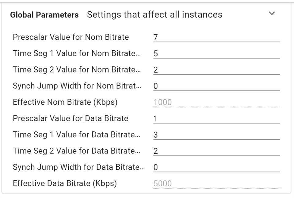

    I have one doubt ccs studio not editable for effective data bit rate column 2 is there.  I attached screen shot below:
    how to fix this issue. I checked all ti mcan questions not solved for M4F, all the answer is working Linux. which version board support m4f can external transceiver tell me.
    Veerapandiyan V.
  • Hi Veerapandiyan,
    Bitrates and sampling point are calculated using the following formulae:
    bit rate(bits per second) = (CAN clock in Hz) / BRP / (1 + TSEG1 + TSEG2)
    Sampling Point(%) = (1 + TSEG1) / (1 + TSEG1 + TSEG2)
    (Note: Values selected in Sysconfig / the values set in structure are directly programmed in MCAN register bit fields. The actual interpretation by the hardware of this value is such that one more than the value programmed.)
    For example:
    Default values used for NOM bit rate are
    MCAN_BitTimingParams::nomRatePrescalar = 7 (BRP = 8)
    MCAN_BitTimingParams::nomTimeSeg1 = 12 (TSEG1 = 13)
    MCAN_BitTimingParams::nomTimeSeg2 = 5 (TSEG2 = 6)
    bit rate = 80MHz / 8 / (1 + 13 + 6) = 0.5 Mbps
    Note: Make sure to also calculate the sampling points in a similar manner and set it on your host side. If all parameters are not set correctly, there will be no acknowledge of data transmission from the host and transfer of data will fail.
    Aparna

  • Hi Aparna,
     Already same settings is there. I use 500kbps bitrate 8mhz oscilator how to apply this value in ccs code tell me.
    Veerapandiyan V.
  • Have you also set the sampling point correctly?
    What is the reason for you to set it at this exact bitrate 500 kbps?
    You can use the above formula to make combinations and get it.
    Aparna
  • Hi Aparna,
    One more doubt two effective data bit rate is which one i edit 1st one or 2nd tell me.
    Veerapandiyan V.
  • Hi Aparna,
    I changed bitrate also but not working how to fix attach below image
    Veerapandiyan V.

  • Hi Aparna,
    My code working for A53 core is perfect working M4F only not working. So you send your working code this mail Id veerapandiyan@etanamobility.com i will check. Then you send your working can output screenshot and your hardware images also. I will check my side.
    Veerapandiyan
  • Hi Aparna,
    I will check different testing.
    1. A53 i mismatch the bit rate MCAN RX is not working Arduino serial monitor also show for error sending message attached image below:
    2. A53 is match the bit rate MCAN RX is working Arduino serial monitor also show for sending message successfully attached image below:
    3. I am debug the M4F core not press play icon show error sending message attached image below:
    4. I am debug the M4F core press play icon show sending message successfully attached image below:
    5.I will check MCAN TX RX pin state is getting:
    RX: MCAN 1 RX PIN STATE =  1
    TX: MCAN 1 TX PIN STATE =  0
    I will check document Transmitter pin only enable, Receive pin is disble how to fix the problem. I need for only read how to change settings tell me.
    Veerapandiyan.

  • Hi Veerapandiayan,
    You cannot use this example directly, but you can copy the content of mcan_tx_only_interrupt.c into mcan_loopback_interrupt.c
    Also, use the function i.e. mcan_external_read_write_main() in main.c
    Let me know if this works.
    Aparna
  • Hi Aparna,
    I changed to mcan_loopback_interrupt.c file compile is done but not transmitting data bitrate also same 1000kbps but not transmitting data. I attached screenshot below:
    changed to mcan_loopback_polling.c file compile is done but not transmitting data bitrate also same 1000kbps but not transmitting data. I attached screenshot below:
    previous mcu+sdk example code also tranmitting working fine but this code not working transmit. How to solve this problem.
    Veerapandiyan V.
  • Can you tell where does the code fail to
    work?
    You can add a breakpoint and check this.
    Aparna
  • Hi Aparna
    I am getting the error in this line only , while i checked with breakpoints
    /* Wait for Tx completion */
    SemaphoreP_pend(&gMcanTxDoneSem, SystemP_WAIT_FOREVER);
    Veerapandiyan
  • Hi Veerapandiyan,
    Can you reset the board and try again?
    This error indicates, the bit timing parameters of the sender and receiver DONOT match.
    The bit rates and sampling points are important to establish connection.
    I do not see any sampling point setting parameter in your Arduino code. Can you figure out a way to do this?
    Aparna

  • Hi Veerapandiyan,
    Here are my global parameter values:
    Apart from the Nominal bitrate and Data bitrate, I am also calculating sampling point and setting it on PCAN view software. Only then, I am able to send and receive data correctly.
    Aparna
  • Hi Aparna,
    I need some clarification i am using transmitter side MCP2515 module :
    CAN Clock = 8Mhz
    Baud Rate = 500 Kbps
    how to calculate prescaler, tseg1 and tseg2.
    Veerapandiyan V.
