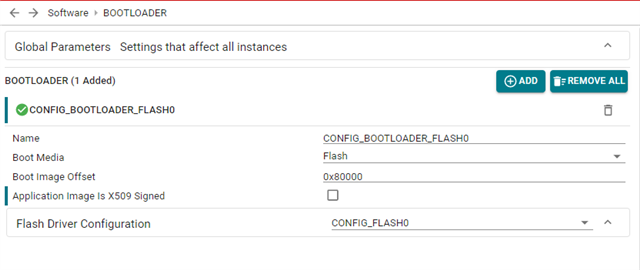

    When booting the application on the EVM from OSPI I get following message:
    I suspect the issue comes because of Authentication failure which is performed on HS boards. You can once try skipping the Authentication check & see if the application boots.
    Please uncheck the "Application Image is X509 Signed" box in the Sysconfig of SBL OSPI like shown below. Unchecking this ensures there are no Authentication checks performed.
    Let me know if this change boots the example.
    Prashant
    Ok I'll give it a try. Could you maybe explain why exactly this is necessary?
    Thx!
  • It worked... Still I understood it that way, that the application has to be X509 signed right? What does that mean and why?
  • the application has to be X509 signed right? What does that mean and why?
    So, the Authentication checks are something that are specifically done on HS devices to enforce secure booting.
    The appimage is signed with a X509 certificate resulting in the bootable image with extension `.appimage.hsfs`. The SBL at run time first requests the System Firmware to do authentication of the image. Only if the authentication is successful, the SBL goes ahead and boots the application.
    Now, the failure you observe "Some tests have failed!!!" might have been caused by this Authentication failure of the appimage & so the SBL did not boot the appimage.
    What I suggested was to basically skip this authentication check (not recommended at all for production on HS devices) & see if the appimage boots. In this case, the SBL at run time will directly boots the appimage without any checks.
    Prashant
