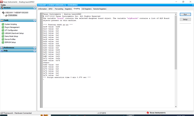

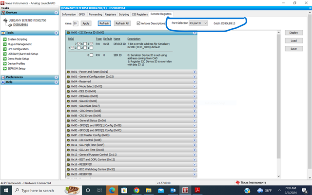

  • Hi Darrah
    Thankyou for the reply.
    While checking with ALP i have observed as shared in the below image. The partner information is not showing in the information tab. Is that okay?
    Sithara Tresa Chacko
    That is strange, are all other features of ALP working as expected? It looks like access to the 913 registers is available. Can you try running the ALP Profile Update, available here, and see if that makes a difference? As long as you are still able to read and write registers, the information tab not populating this info should not be a problem. Listing the partner device info is not crucial to other functions.

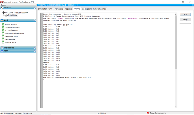

  • Hi Darrah
    Thankyou for the update on alp profile. I'm not able to see the partner information still.
    Also as a part of debugging ,I just tried to read the register address with my cameras(without writing any reg values using the script). Used the below script to read the reg values in scripting tab.
    /cfs-file/__key/communityserver-discussions-components-files/791/readpythonfile.txt
    Camera1:Has been already bring up with sdk.(Also an ISX016 SONY Camera but not the same as Camera 2)
    Camera2:The same camera we are discussing in the this thread which from logs initializes and also starts but no streaming.
    Please find the register values read in both cases.
    CAMERA 1
    CAMERA 2
    The register values(0x73-0x76)values are present for CAMERA2 which is not streaming and no values for working CAMERA 1.
    Can this observation be used for further debugging
    Thankyou
    The images and register reads look the same for both cameras. Was the same picture uploaded for both cameras perhaps? When you say "without writing any reg values using the script", do you mean the initialization script has not been run on the cameras, or do you mean after initialization the attached script is ran, which only contains reads?
  • Hi Darrah
    Apologies for the confusion . I have pasted the image incorrectly
    Camera1
    /resized-image/__size/640x480/__key/communityserver-discussions-components-files/791/2577.justread.PNG
    Camera 2
    /resized-image/__size/640x480/__key/communityserver-discussions-components-files/791/justread1.PNG
    I have tried to get this values before running the initialization script.
    Could you help me resolve my confusion?
    This new image shows some data is being received. Without the initialization script, the sensor won't be programmed so it will be difficult to determine anything from the registers as the sensor will not be active. Additional details to answer your questions are listed below:
