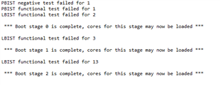

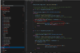

  1. In bist.c, what does "PBIST negative test" mean? Also, why to be wrong when "testResult !=0"? Pls refer to the picture.
  2.  What is the difference between "PBIST negative test" and "PBIST functional test"?
  3. For the test result, can it be read by stage cores?

    1. testResult = 0 or SDL_PASS is considered the pass condition in the code sequence. Hence testResult !=0 returns a failure.
    2. Negative testing ensures the system works as expected under error conditions. The Safety Manual has diagnostics for Software Test of PBIST, for example: A72SS.RAM-T2 - Software Test of PBIST, "where it is possible to configure the PBIST logic by selecting an algorithm that should fail and seeing if the PBIST Logic reports an error under this condition".
    Whereas the Auto-coverage diagnostic mentioned in the safety manual measures are based on the probability of a random failure causing PBIST to falsely pass a test. The PBIST check of memory diagnostic provides a reliable way to identify stuck-at/permanent faults in the memory. Both these cases are taken care of by the functional test.
    'SDL_PBIST_TEST' takes care of normal scenario and 'SDL_PBIST_NEG_TEST' injects error and verify that module is able to detect errors in a desired way.

    1. From your code, the testResult is added "1". Therefore, failure case results to testRsult as 0.
    3. In this example, MCU1_0 triggers the BIST test of other cores and reads the test result. I mean whether the tested core reads the test result after MCU1_0 triggers the BIST test of the tested core and boots it.
  • Hi Dengkuan,
    Please note that the pbist_pre_boot_stage_neg_status[i] has the value of testResult +1 (0 - fail; 1 - pass). The value of testResult remains the same (-1 - fail; 0 - pass).
    Yes, it is possible to check the test result by reading the status registers of the PBIST controller of each core.

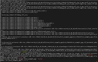

    There are 2 MulticoreImageGen in /ti-processor-sdk-rtos-j784s4-evm-09_01_00_06/pdk_j784s4_09_01_00_22/packages/ti/boot/sbl/tools/multicoreImageGen. You should use the MulticoreImageGen.exe instead of MulticoreImageGen. That is what seems to be the issue. Since we do not test on Windows, I am unable validate this fix.
    Josiitaa
  • Josiitaa,
    How should I do this change?

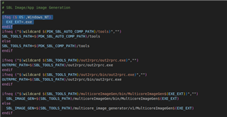

    Include the highlighted section of code in SDL/build/makerules/common.mk
    I tried to use this which you suggested. But, I cannot find what to be changed for j78s4. Can you attach a whole project so that I can refer?
    I am trying to reproduce your failure on my side so I can generate the patch. Could you share your error logs for this case?

  • I switched to Ubuntu in VMware and built the bist_example_app based on J721E SDK 09_01_00_06. It shows the following error:
    # /home/sdkuan/Downloads/ti-processor-sdk-rtos-j721e-evm-09_01_00_06/sdl/binary/bist_example_app/bin/j721e/bist_example_app_r5f_baremetal_debug.xer5f created.
    /bin/sh: 1: mono: not found
    make[1]: *** [/home/sdkuan/Downloads/ti-processor-sdk-rtos-j721e-evm-09_01_00_06/sdl/build/makerules/common.mk:304: sbl_appimagerprc] Error 127
    make: *** [makefile:144: bist_example_app] Error 2
    Mono is required for building the SDK on linux. You can check if mono is installed by typing “mono –version” at the linux prompt. If mono is not installed, download and install mono from this link - Home | Mono (mono-project.com)

    The Fail Status Fail Register (FSFR) is expected to be all zeros if PBIST passes successfuly. You can find the value of PBISTRegs for each instance in the sdl_soc_pbist.c file in SDL/src/sdl/pbist/soc/j721e directory.
    As mentioned in my previous reply, you have to verify that the values of the FSFR are zeros, to check the PBIST result from a different core.

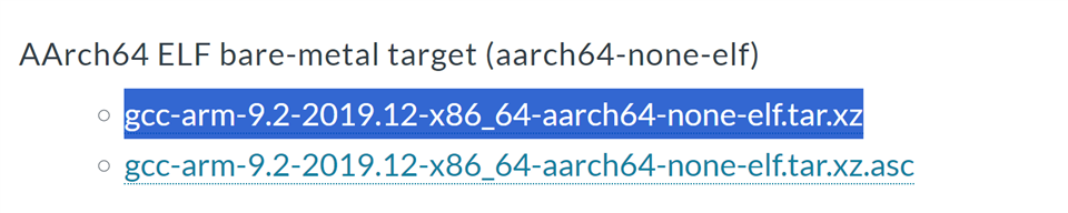

         When I tried to run this command, it shows the error "gcc-arm compiler not found. Please refer user guide to download the same"

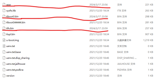

    2. Copy sbl_mmcsd_img_mcu1_0_release.tiimage as tiboot3.bin to the boot partition of SD card
    3. Copy tifs.bin to the boot partition of SD card
    4. Build boot_app_mmcsd by using the following command
      • make BOARD=<board_name> CORE=mcu1_0 boot_app_mmcsd -sj
    5. Copy sbl_boot_app_mmcsd_<board_name>_mcu1_0_freertos_TestApp_release.appimage image as app to the boot partition of SD card
    6. Copy stage1 image as lateapp1, stage2 image as lateapp2 and stage3 image as lateapp3 to the boot partition of SD card   Does that mean changing multicore_MCU1_0_MCU1_0_stage1.appimage to lateapp1?
    You will have to install this compiler in the RTOS SDK folder from this link - Downloads | GNU-A Downloads – Arm Developer
